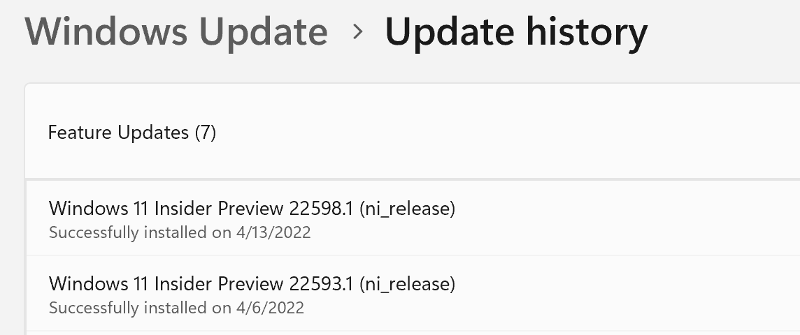

I noticed another issue common to all the Ni builds, if they are used for an upgrade or in-place they may only work correctly if they are done online allowing the check for updates.
If I use the option "Change how Setup download updates" to "Not right now", the upgrade or update in place still completes, but it creates a problem on subsequent W.U.
In this case W.U. goes in a loop trying to Download and Install the same Build over and over. Error 0xc1900401 is logged in that case.
I could not find a way out of that loop.
If I do the same upgrade or update in place online letting the Setup check for updates, as recommended, the process may complete correctly without subsequent W.U. loop issues, but the behavior is inconsistent depending on how the previous update was done.
The official MS Insider ISO 22579 includes all the required Apps and the Microsoft.SecHealthUI which is needed for opening Security.

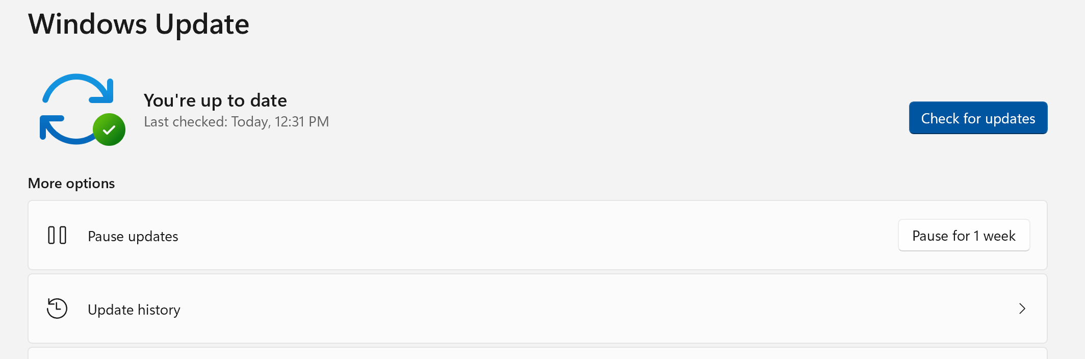

    Hi Johnny,
    I just verified the suggested workaround from Dream W, not sure if it will work on your VM, but it worked perfectly on the real machine.
    I reproduced the problem again with the error 0xc1900401 and then clicked on Pause Updates with default (Pause for 1 week) and resumed right after.
    That took care of the W.U. loop and the error disappeared from the update history too. πŸ˜‰
    Unfortunately, 2 other updates for Intel that were pending to download and install disappeared too. 🀣
