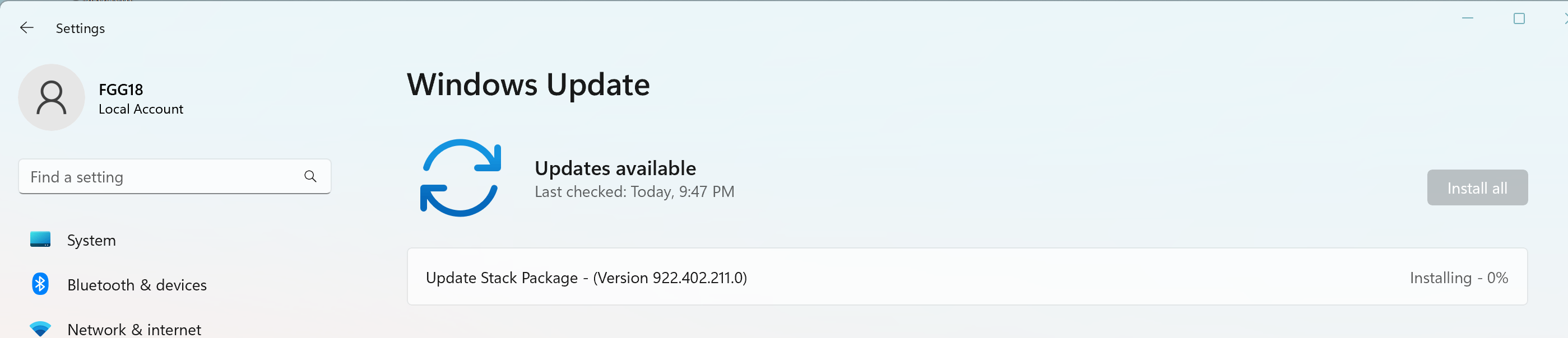

    Used the same ISO to do upgrade from 22581 -> 22593 on 3 machines and got the W.U. loop after that.
    They definitely have a bug with the way they check for updates.
    I also used the same ISO to upgrade from 22000.593 -> 22593 on a VM and didn't get the loop.
    IDK what's going on but definitively a bug.

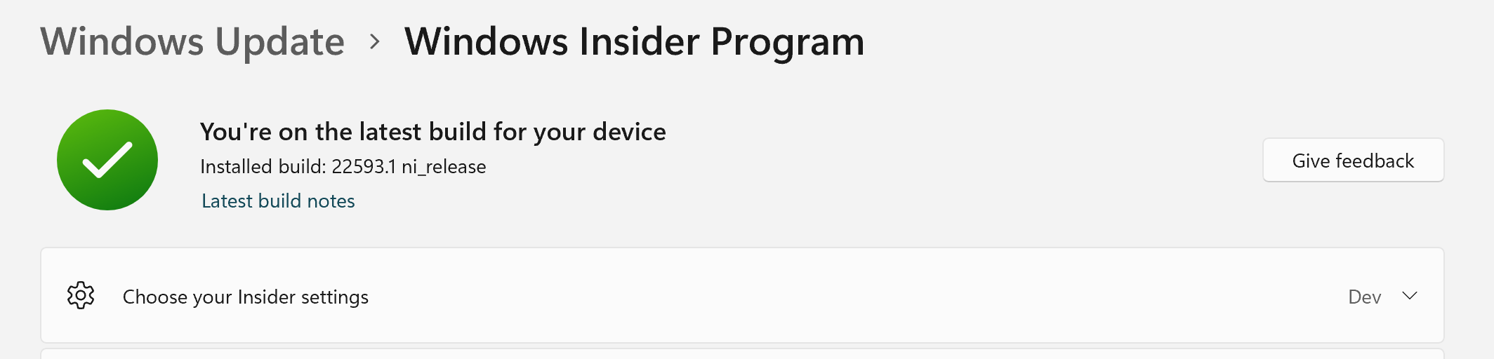

    Hi Sibro,
    Same as you on this upgrade, no W.U. loop after upgrading 22000.593 to 22593.1 with ISO.
    The only W.U. update that came down after the upgrade was this one below:
    MS Store pulled down 17 Apps updates.

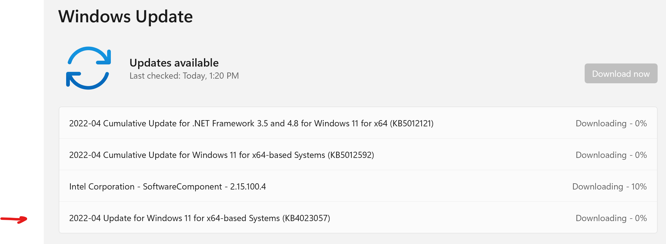

    2022-04-11T03:43:50+00:00
    I got that kb4023057 with W.U. on all the public builds a few days ago. Windows 10 and Windows 11 got the same kb#.
    I'm not getting it on 22000.593 hence my original question but thanks for the explanation anyway. 👍
