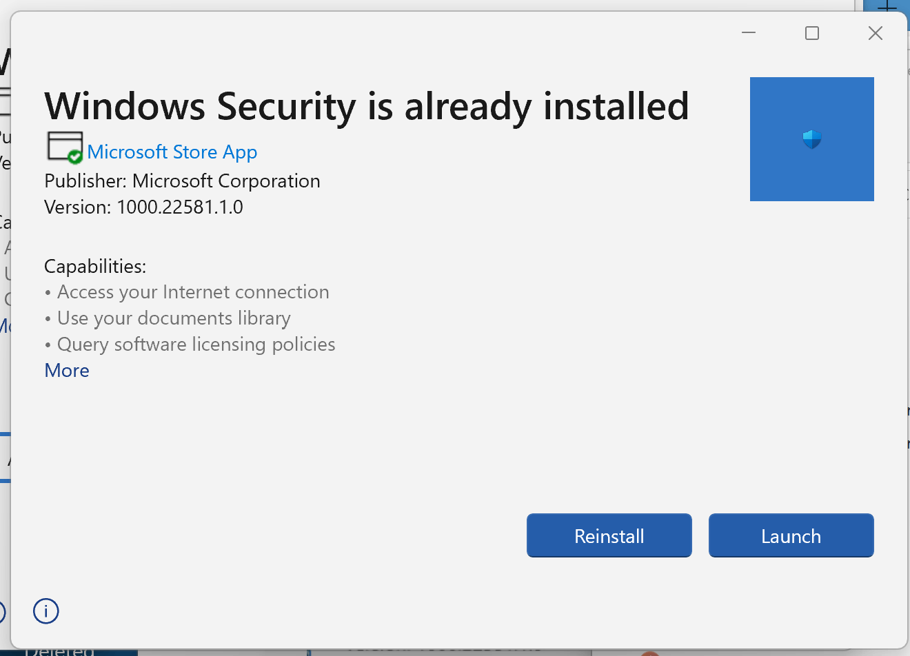

I created all 5 installation ISO files for all 5 Builds, but only 22557 contains all the system Apps required for a full clean install, the other 4 are missing all the basic Windows and System Apps needed for a functional system. Also, the App required for opening Windows Security (Microsoft.SecHeatlthUI) is missing, all this makes the resulting system unusable.
Last one on 22557.
Microsoft.SecHealthUI Microsoft.SecHealthUI_1000.22557.1.0_x64__8wekyb3d8bbwe

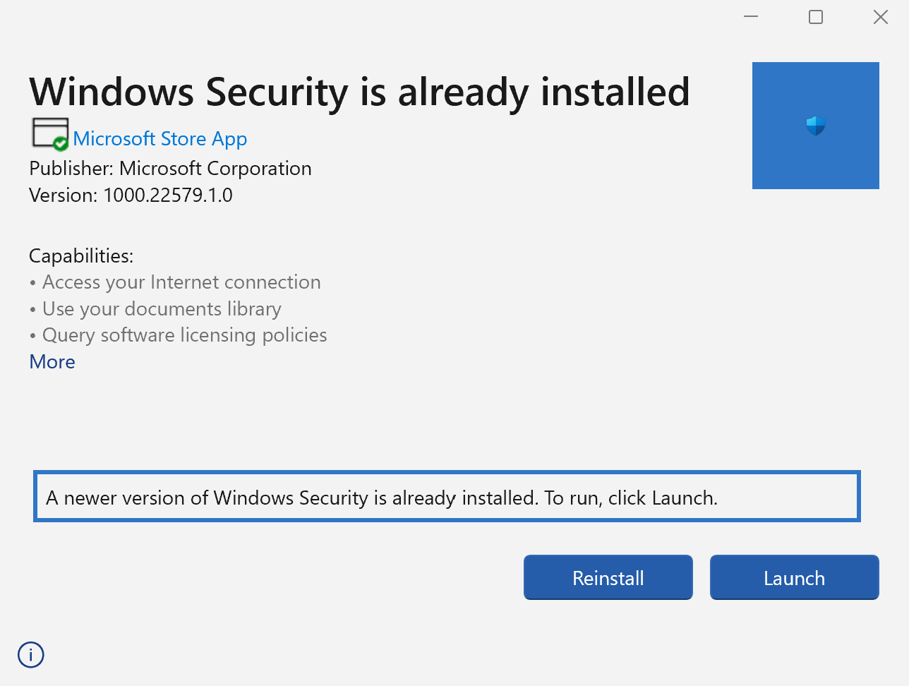

The official MS Insider ISO 22579 includes all the required Apps and the Microsoft.SecHealthUI which is needed for opening Security.

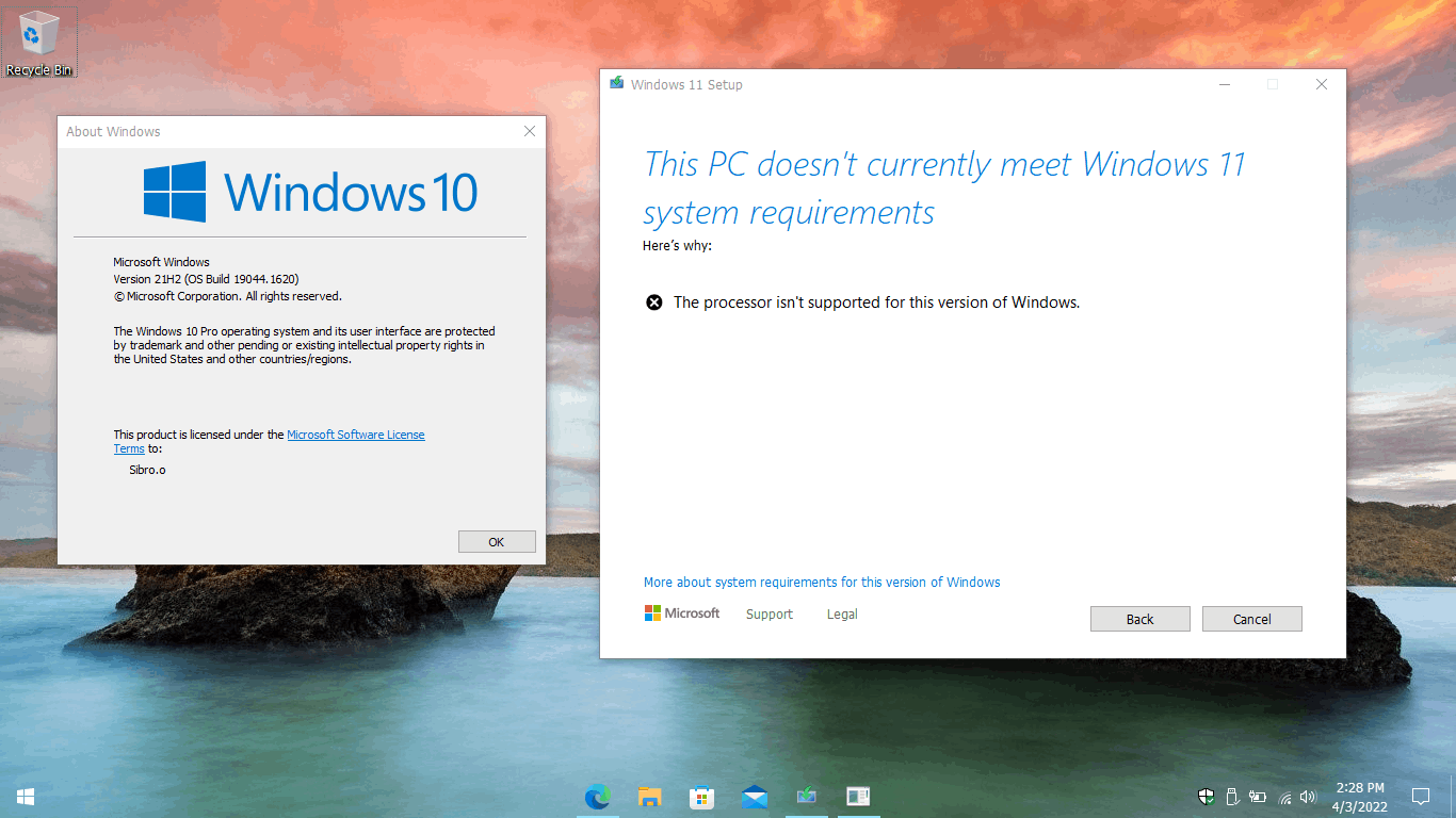

    You may be able to bypass the check for the processor if you really want to. Let me know if you want to try.
    No thanks, I know I can bypass the check but I don't want to.
    I have no problems clean installing/updating W11 on a VM or this laptop, this issue is exclusive to 19044.1620

    I kept trying to confirm Widgets but I cannot upgrade in-place from 19044.1620 to 22581.200, the result is always the same, either on VM or laptop. No problem clean installing or updating in-place 22581.200 using the ISO so IDK what's going on.
    btw, the first two times I run setup.exe I got the alternate menu as if I was trying to update from USB, on the third time the correct menu showed up.
    You may be able to bypass the check for the processor if you really want to. Let me know if you want to try. 😉
    I can do the upgrade from 19044.1620 to 22581.200 also on a red zone box, but have to use some old tricks and starting from R.P. then change to Dev after it is done.

    It is fine when using MS ISO 22579. and then W.U. to 22581.200

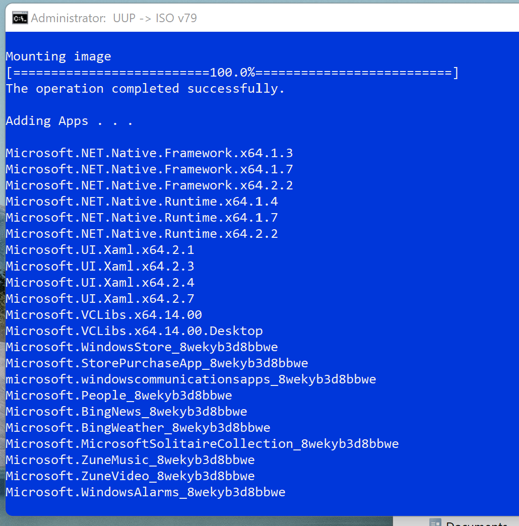

    As you like to make an ISO from SoftwareDistribution, when you dl the apps from the dump, just retain the 57 files in the Apps folder and copy them to wimlib every time you create an ISO. You will be good to go.
    Regards,
    Hi Johnny,
    This is what it downloads with the new script v79 for 22581.200.
    The _AppsFilesList.cvs has a list of 3278 files the Apps folder has 57 Subfolders with the Apps bundles.
    Still the question remains, is there a set of Updated Apps that needs to be downloaded with every new build?

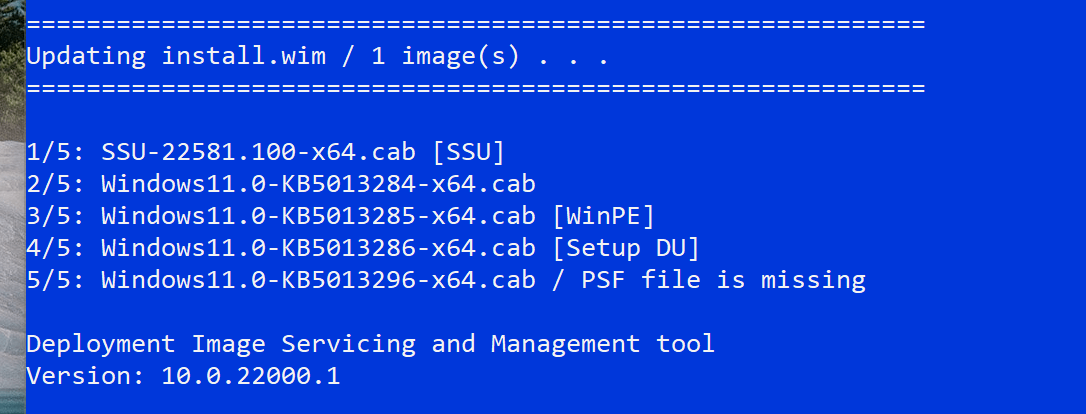

    Got this message when using SoftwareDistribution "PSF file missing"
