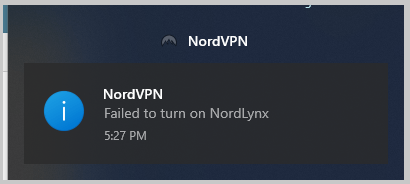

    I have NORDVPN, I just tried using it with Development Build 21364 and I get an error message.
    Latest NORDVPN update got up to 6.35.9.0. also noticed that during the update it installed Visual C ++.
    The Login procedure for NORDVPN seems to be changed, I also have problems connecting,  it pops up a notification message Stating "NordVPN failed to turn on NordLynx"
    So I switched the VPN Protocol to "OpenVPN (TCP) and it finally connected.
    It was set for "Choose a VPN Protocol and Server automatically"  and that gave me the error above.
    I just saw that there is a newer version of NORDVPN 6.36.6.0, I have that on 20H2 system, but have not tried on Development build 21364.1000 yet.
    The strange thing is that on the NordVPN site the latest they show for windows is 6.35.9.0, but my laptop was just updated automatically to 6.36.6.0, perhaps it is still a Beta version ?

    Tried NordVPN 6.36.6.0 on Build 21364.1000, I see no difference from previous version, still had to select OpenVPN (TCP) to get it working.
