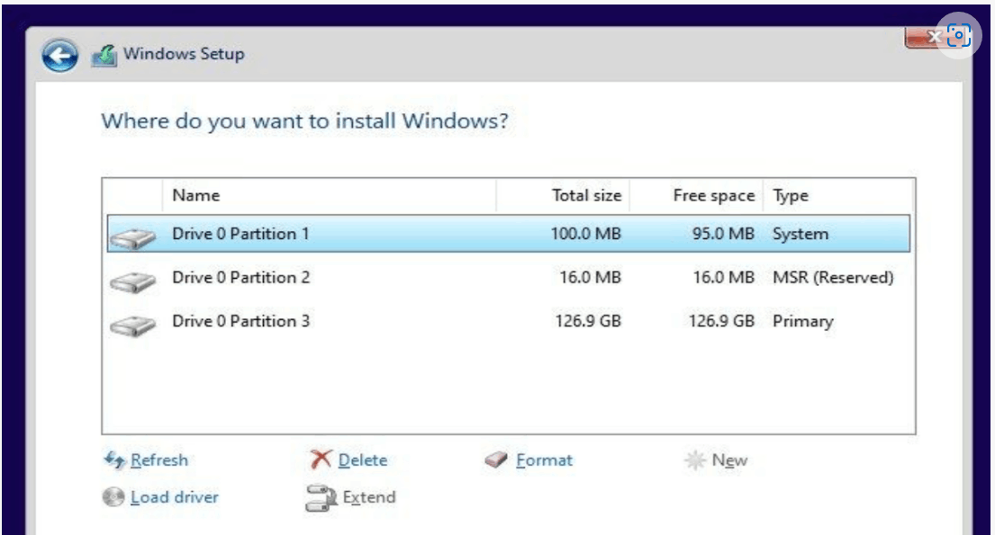

    The VMD is like an extra system or separate chip and at the moment you have to load the drivers manually when at this screen, W11 might have the drivers within it but does warn you if you remove or damage the VMD drivers you will end up with a blue or green screen depending on Insider or public release.
    I don't know the mechanics behind the screen below so I can only go on what I have read at Intel and Asus web sites.
    Not only do the drivers have to be right but the bios settings for VMD must be set correctly. The original installation might be damaged beyond repair

    He had problem, see first post, I am not sure what he sees at that screen where you load the driver and he also told us what drivers he tried to install which were the wrong ones.
    The error he posted is to do with Windows so the driver are not loading with the one he tried to install
    We need to know what happens at that screen and in what time scale as loading drivers only takes a few seconds and the SSD drive should show, if it doesn't show there is a problem either with the driver or bios setting or both.
