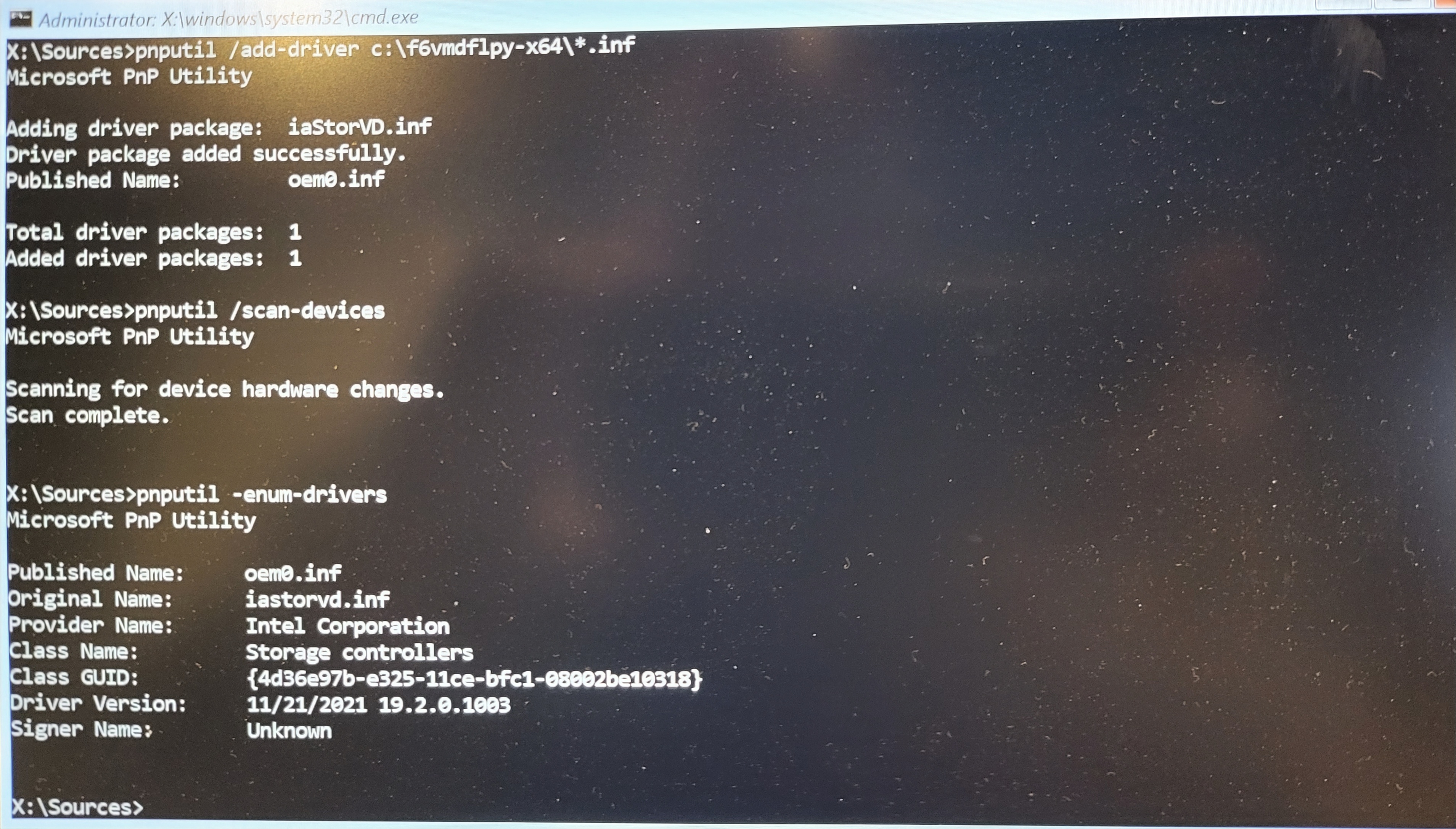

    Thanks. Tried that a few times. no luck, unfortunately. Same Watchdog error & looping
    YW.
    Please try again using the newer driver from the link Bryce posted earlier F6flpy-x64 - VMD.zip
    edit: never mind, you used the latest driver.
    Did you try using W10 MCT?

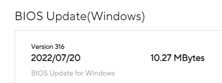

    Apparently there is a new bios version available, have you tried it?
    Zenbook 13 UX325 (11th Gen Intel)

    Your picture above about rebuilding is normal if say a power cut or power switch is turned off and once power is restored.
    I downloaded the 11th and 12th Generation Platform and once extracted ended up with these files, if you added them to the Windows install USB (install the extracted folder complete) or just load the drivers using the USB stick they should be laid out like this. I would select the system driver but if you select the wrong one I don't think it comes up or shows, its been a while since I had to load drivers this way.. If it does work stop when it shows the hard drive and decide whether to clean install or repair, loading the right driver should only take a few seconds for it to work.
    At this stage I would not try to update the bios as you might make the problem worse.
    The reason you must load the driver this way is to make a bridge between the bios and Windows.
    Hopefully the SSD will show up in this Window
