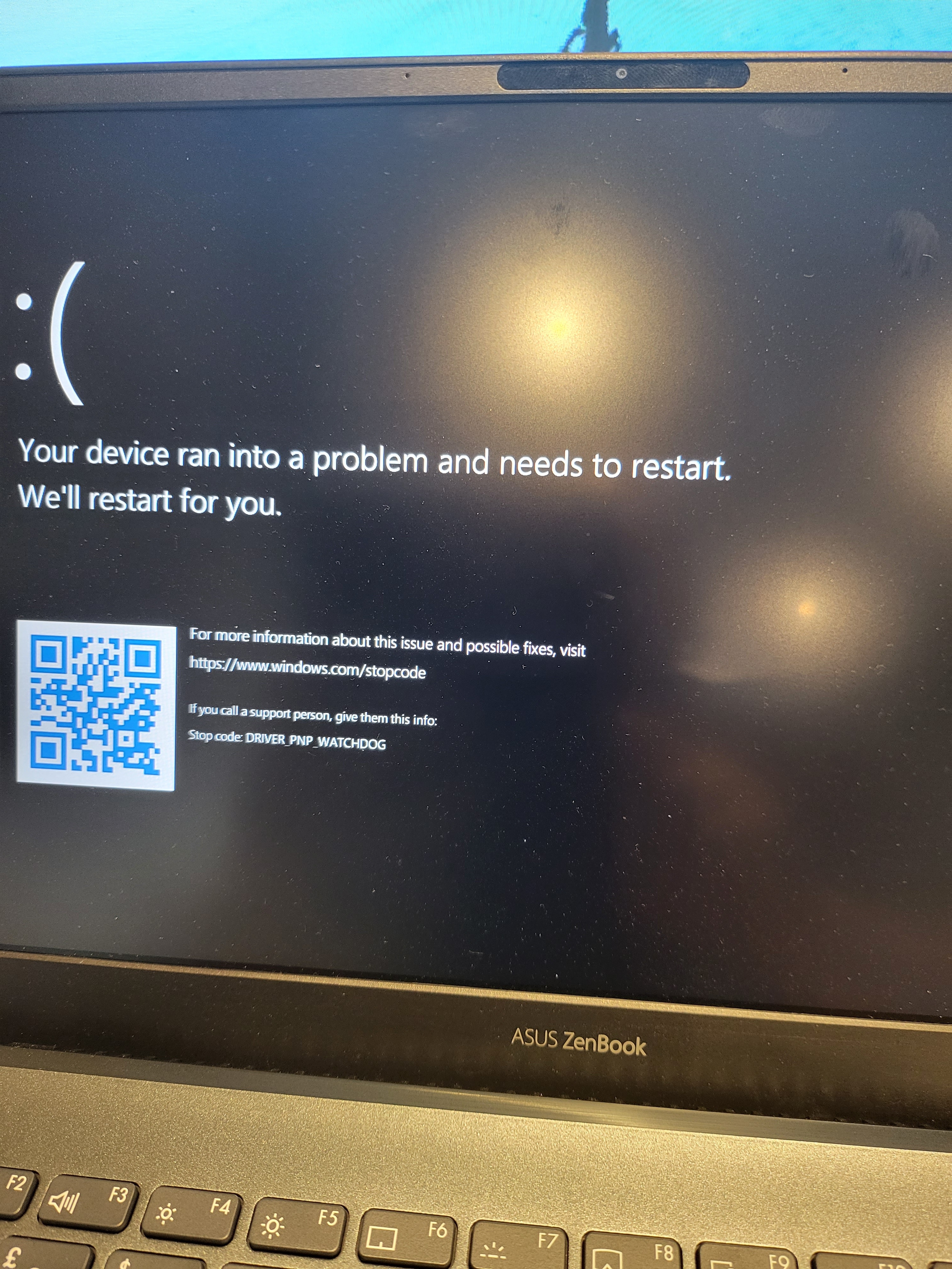

I have an Asus Zenbook. After/during the latest Windows 11 update, I am no longer able to boot into windows. I get Stop code: DRIVER PNP WATCHDOG BSOD, and sometimes INACCESSIBLE BOOT DEVICE. I can't get to the recovery environment, although BIOS is still working.

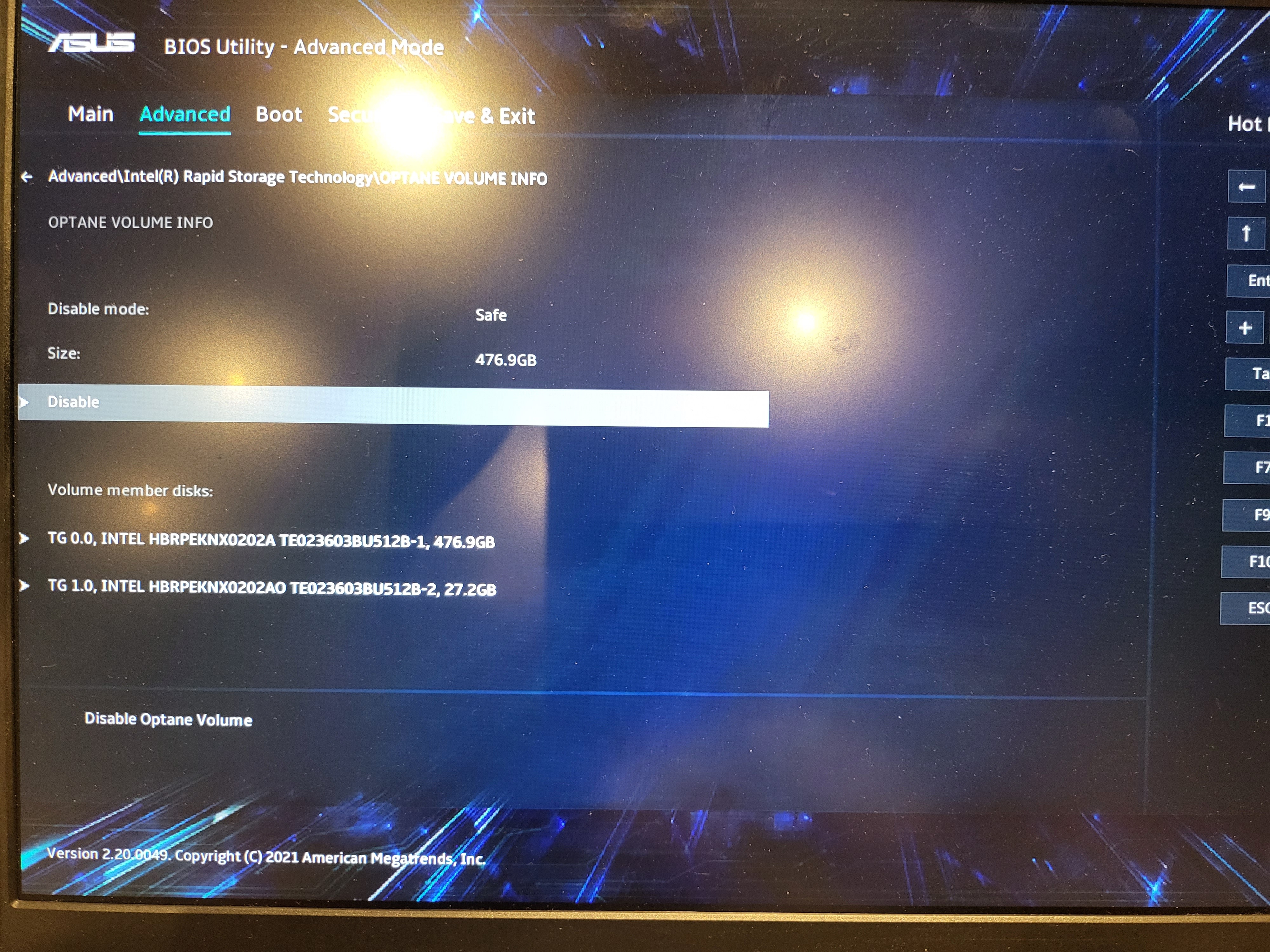

    In the bios under SSD drives can you take a picture of the options please

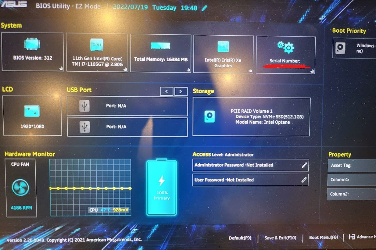

    2022-07-19T19:02:21+00:00
    Whoops. i forgot this one too
  4. BryceSor 5,510 Reputation points Volunteer Moderator
    2022-07-19T23:58:34+00:00
    Thanks and it looks like the motherboard still seeing the harddrive which is good so hopefully it is Windows with the problem, I will do some reading tonight and see if I can help you get pass this problem, unless someone can solve this problem before I can get back.
    The Bios version is 312 so you have the latest and the number 2.20.0049 is the Bios Utility version, the program that you have taken the picture of, sort of confusing.
