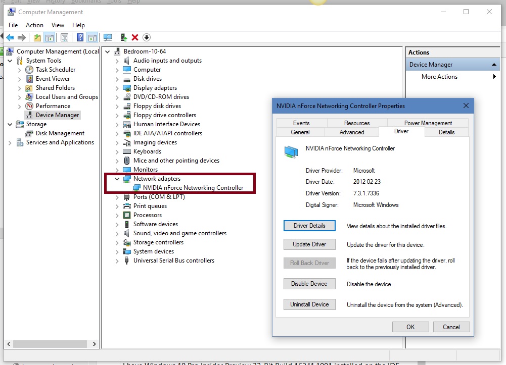

    2017-07-19T06:57:42+00:00
    Hi thecreator,
    I share your pain and frustration BUT you have confirmed my suspicion that it's the motherboard chipset 64bit drivers that are at fault - either missing or corrupted.
    The problem you describe is exactly the same as I'm experiencing AND your Asus P5N-D motherboard uses the very same Nvidia SLI nForce 750i chipset drivers as my Asus P5N32-E SLI Plus motherboard while Cbarnhorst's ASUS P5K-E uses an Intel chipset and he's been successful.
    When I get home on Friday I will try using a 32bit installation to see if, like you, it will update successfully on the Fast ring. That should confirm the problem once and for all!
    The others responding to you plight with helpful suggestions have also been offering me the same advice but, regrettably, nothing has worked .... so far.
    I'd be interested to know if you've succeeded with a clean install of ANY build since 14393.... give the 15063 build a try using the ISO downloaded from Microsoft - if that fails then it would confirm my thoughts on the timing when the drivers were omitted or corrupted.

    2017-07-19T12:22:42+00:00
    Hi thecreator,
    Cheers
    Hi @ GeorgeOgden  ,
    I have Windows 10 Pro Insider Preview 32-Bit Build 16241.1001 installed on the IDE Drive within the same computer without problems. ASUS P5N-D Motherboard.
    I tried Windows 10 Pro Insider Preview 64-Bit Build 16232.1000 ISO Image burned to a DVD-R and it doesn't load. That is, I hit a key and it boots to the DVD, and before loading into Windows 10 for me to make choices, the computer restarts / reboots.
