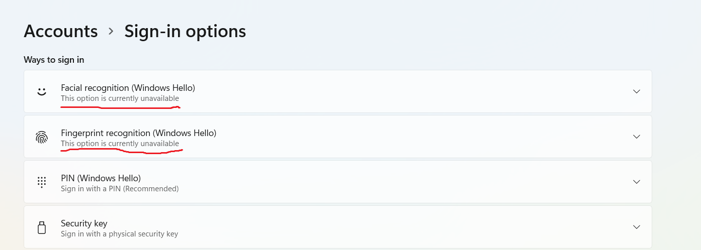

    I'm using a Lenovo YOGA C640-13IML, few days back I updated my system to Windows 11.
    Now Fingerprint Sensor doesn't work now.
    I checked 'Sign in options' and it says Fingerprint recognition & Facial recognition are currently unavailable.
    Appreciate your help,
    Regards,
    Read previous posts. We all have the same problem. Still no solution.
    2021-11-04T14:21:24+00:00
    Got an update from windows today, now fingerprint scanner works fine,
    Thanks,
