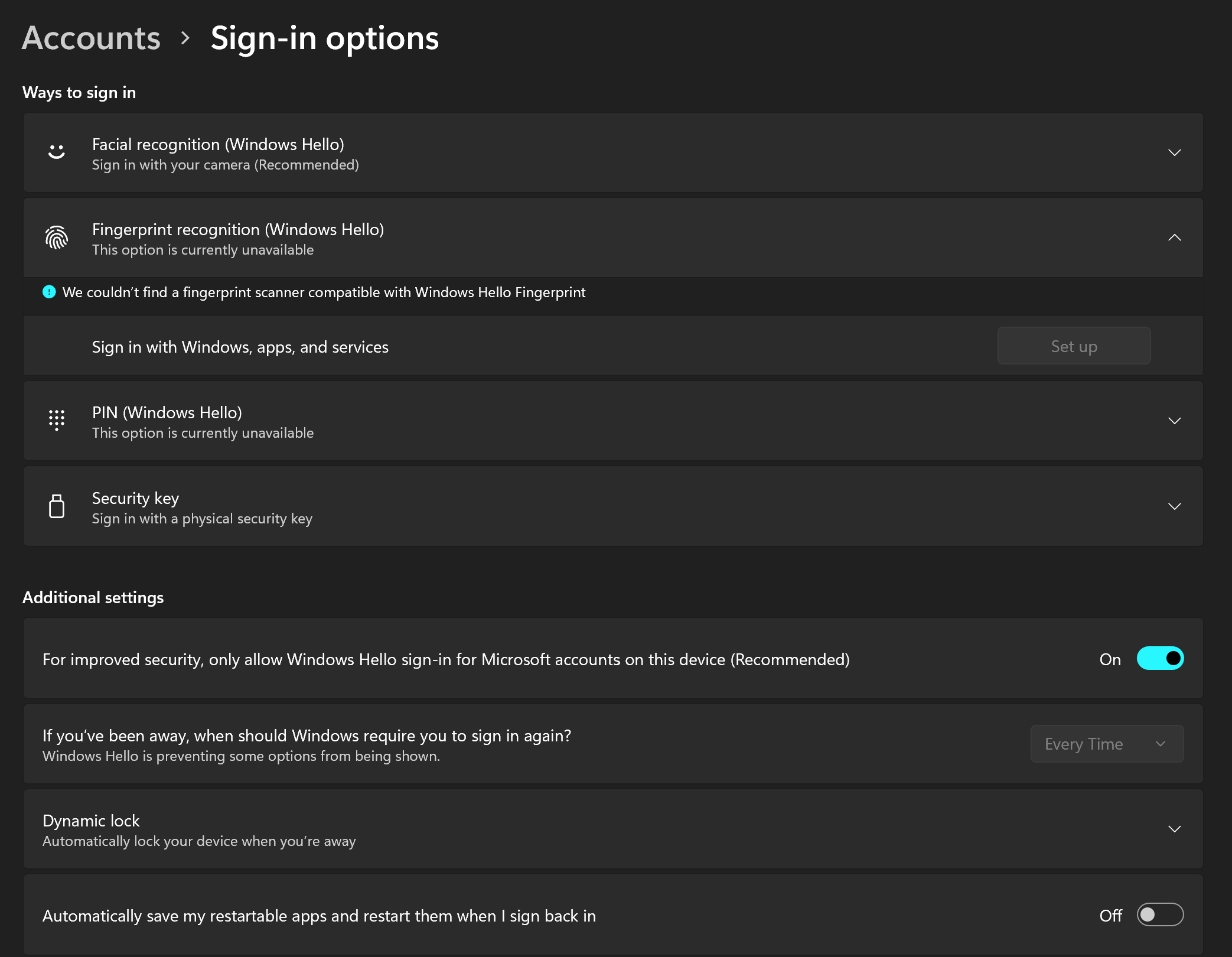

I have an Asus Vivobook 14 X413JA.
Yesterday, I downloaded the windows 11 insider preview build from the dev channel, but I was disappointed to find that windows hello couldn't recognize my fingerprint when I tried to log in.
I tried uninstalling and reinstalling the drivers of my fingerprint sensor but still, it doesn't work.
