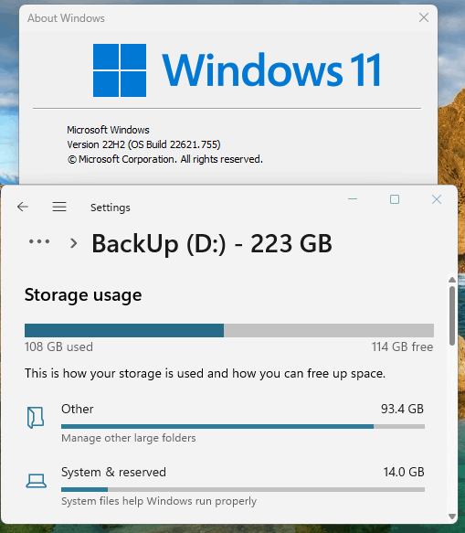

System & reserved files on a secondary drive?
2022-10-30T02:00:47+00:00
Beta build 22623.875 & Dev build 25231.1000
System > Storage > Advance storage settings > Disk & volumes > Disk 1 > Volume name > Properties > View usage
I didn't know about this until now, is this normal? why do we need system & reserved files on a secondary drive?

Copy back a few folders at the time and keep checking to see when those 14GB start showing up in the System files. Then you can isolate which one is causing the problem.
I followed your advise and copying folder by folder does not reproduce the issue.
However, if I copy everthing at once the 14GBs come back. πŸ€·β€β™‚οΈ
Thanks for the suggestion πŸ‘
Done and dusted!
Good that you could clean it up.
I guess we'll never know what caused the problem in the first place.
Perhaps when you got the BSOD?
Probably when you do a clone you copy over also the problem. 🀣🀣

    2022-11-01T03:01:38+00:00
    B.T.W.
    Here is an example of a separate entry for Reserved storage. That shows that is not considered part of the System files. πŸ€£πŸ€·β€β™‚οΈ
    Yeah, I have a problem with System & reserved because it implies System files and the 14GB were not.
    If any, there were File System files not related to nor needed by the OS.
    btw: while doing research, I found out that Reserved storage isn't critical nor needed by Windows to function properly and even detrimental if the system disk is running low on space. I have it disabled now. 😁
