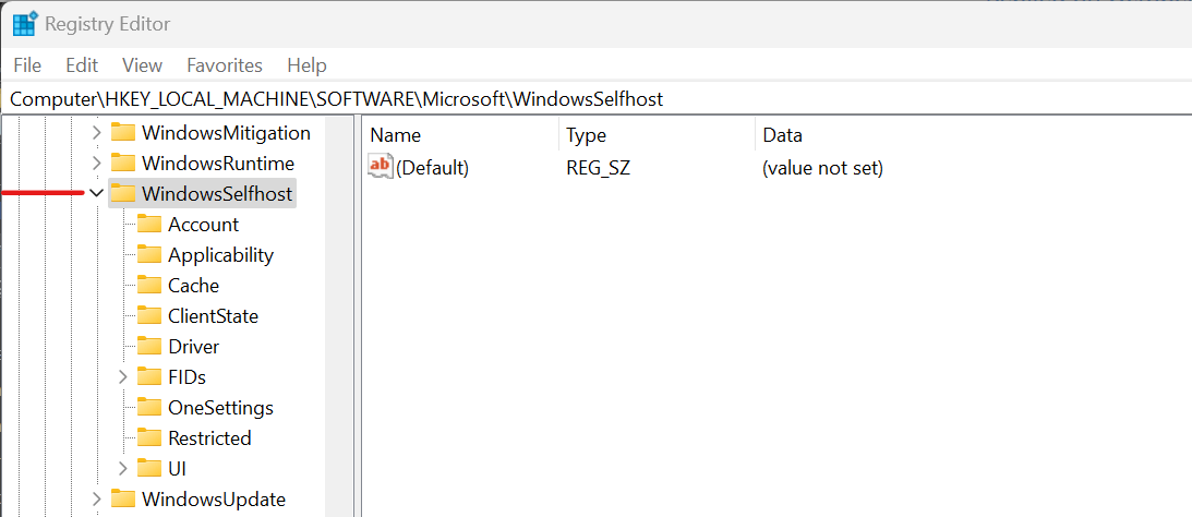

Since your build is 23612, suggest you first reset the Insider settings by deleting the Self Host Key:
HKEY_LOCAL_MACHINE\SOFTWARE\Microsoft\WindowsSelfHost
Download the ISO for Release Preview 26100.560 and do a Repair Install.
Download Windows Insider Preview ISO (microsoft.com)
Mount the ISO and run setup.exe within Windows. This will put you on the RP build. You can join RP if you want, and WU will take you to 26100.712 which will be this fall Release of 24H2. I have not tried running WU without joining RP channel, you might want to try that first to see if the update comes down while in Release.

Hi Gustav,
Deleting that key WindowsSelfHost and rebooting should have taken you out of insider.
If it is still in Dev channel, something did not work as expected.
When you deleted the key and rebooted the first time, did you check the insider page to make sure it was no longer in any insider channel?
It will not work if it stays in Dev channel, it needs to get out of insider.
Good that you paused the updates.
Try deleting that key again and reboot and check to make sure it is no longer on any insider channel.
The "Winver" command should show 26100.560 not just 26100.
Resume updates only when it is non-insider.
Le us know what happens.
