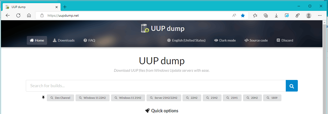

    I just wanted to know what software you used to grab the ISO files
    Thanks and sorry I'm new to this forum
    I usually hang out at the [H]ardForum
    2022-08-16T01:16:27+00:00
    Neat what software is this?
    Why did you get an old ISO?
    Hi fg,
    I don't think he did, that is your post from page one. 🤣
    He was just complementing it.
    I see that now, I thought he tried himself. 🤣🤣🤣
    OK sorry, I thought you found it by searching the web.
    There is a third-party site where you can download the scripts to create the ISOs when they are not available from MS.

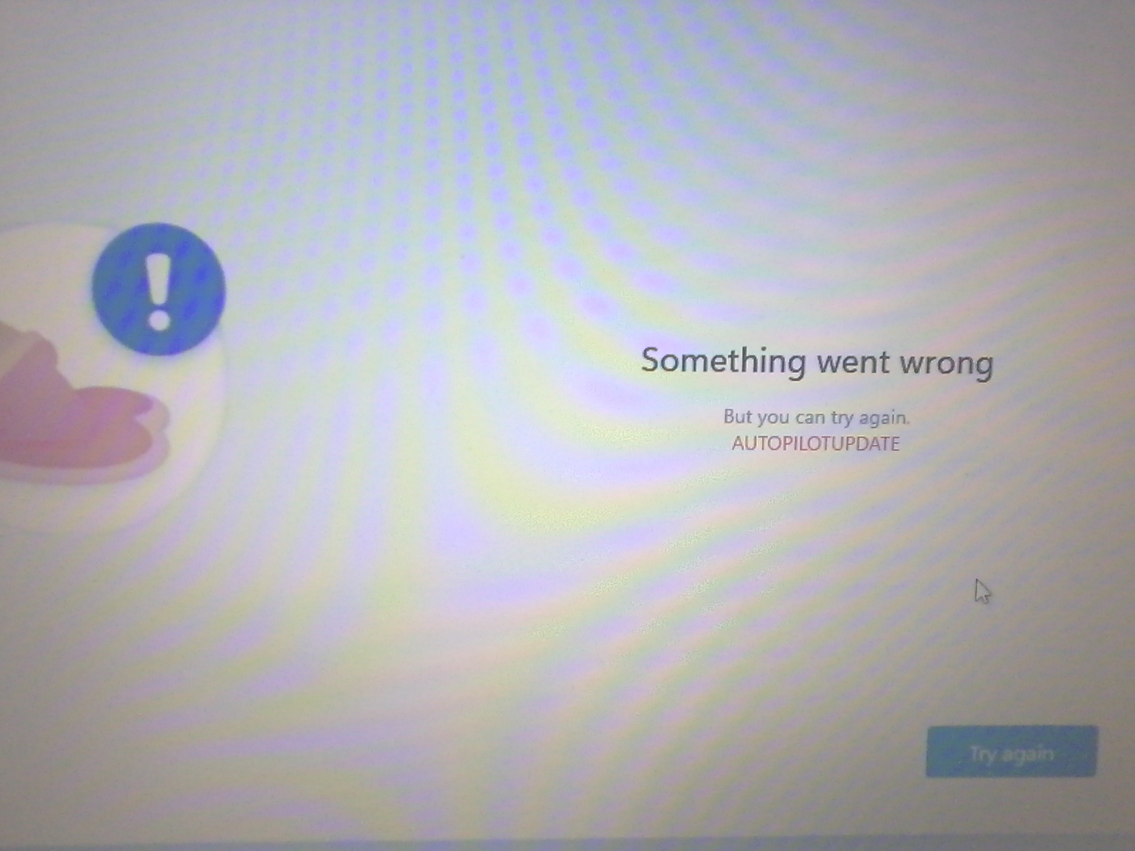

    2022-09-04T02:45:30+00:00
    I'm not sure when this took effect but oobe\bypassnro doesn't work anymore (build 25193)
    Instead of the regular options, right away the installer tries to check for updates and this comes up
    I could not find a way out. I tried oobe\bypassnro one more time , same result.
    Also, I couldn't perform an in-place repair on this clean installation without using a hack. AFAICR, this is the first time this happened to me with a Dev build on this yellow zone laptop.
    2022-09-04T05:48:54+00:00
    Hi Sibro,
    Confirm, I see the same message with 25193.
    I had to connect the ethernet and then hit "Try again" to get over that message "AUTOPILOTUPDATE" and then it continued.
    Note that at this point it did not give me the choice for connecting the Wi-Fi either, I just connected the ethernet and hit Try Again. 🤷‍♂️
    It let me connect with Wi-Fi when I did a normal install without using oobe\bypassnro. 🤷‍♂️
    Always some new changes. 🤣
    I never heard anything about AUTOPILOTUPDATE. 😎
    What's new in Autopilot | Microsoft Docs
