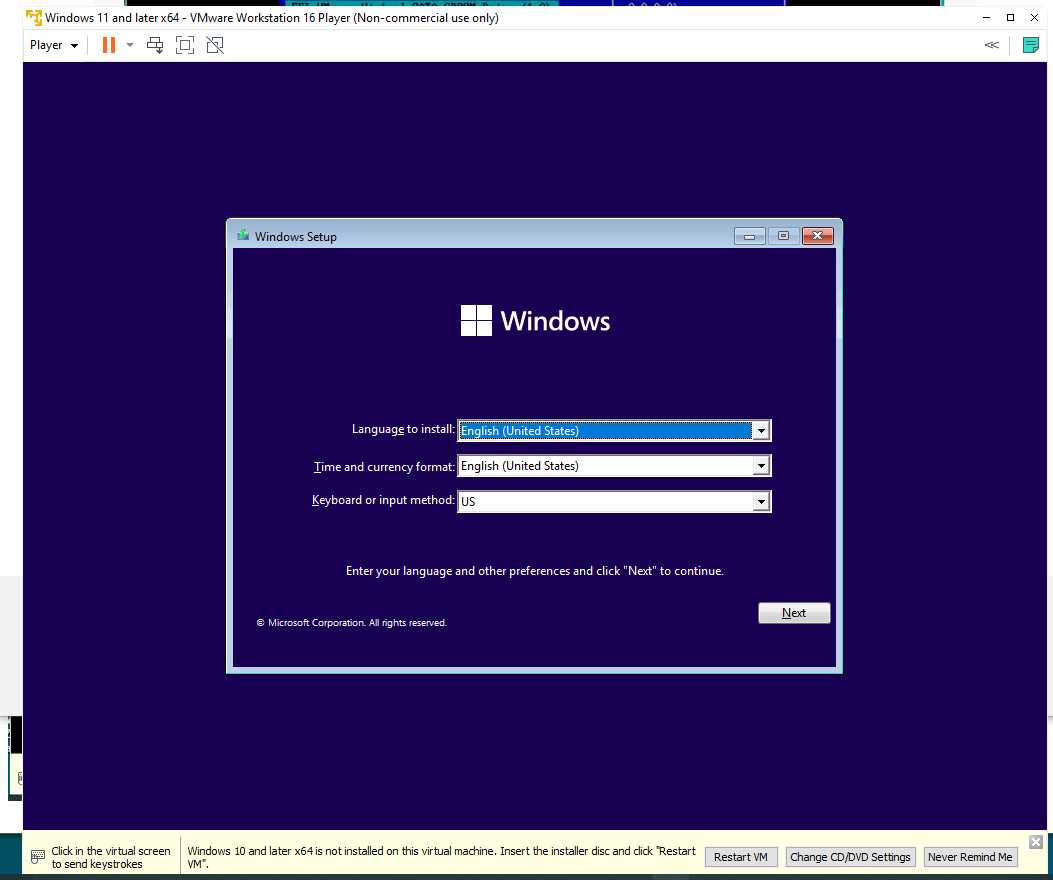

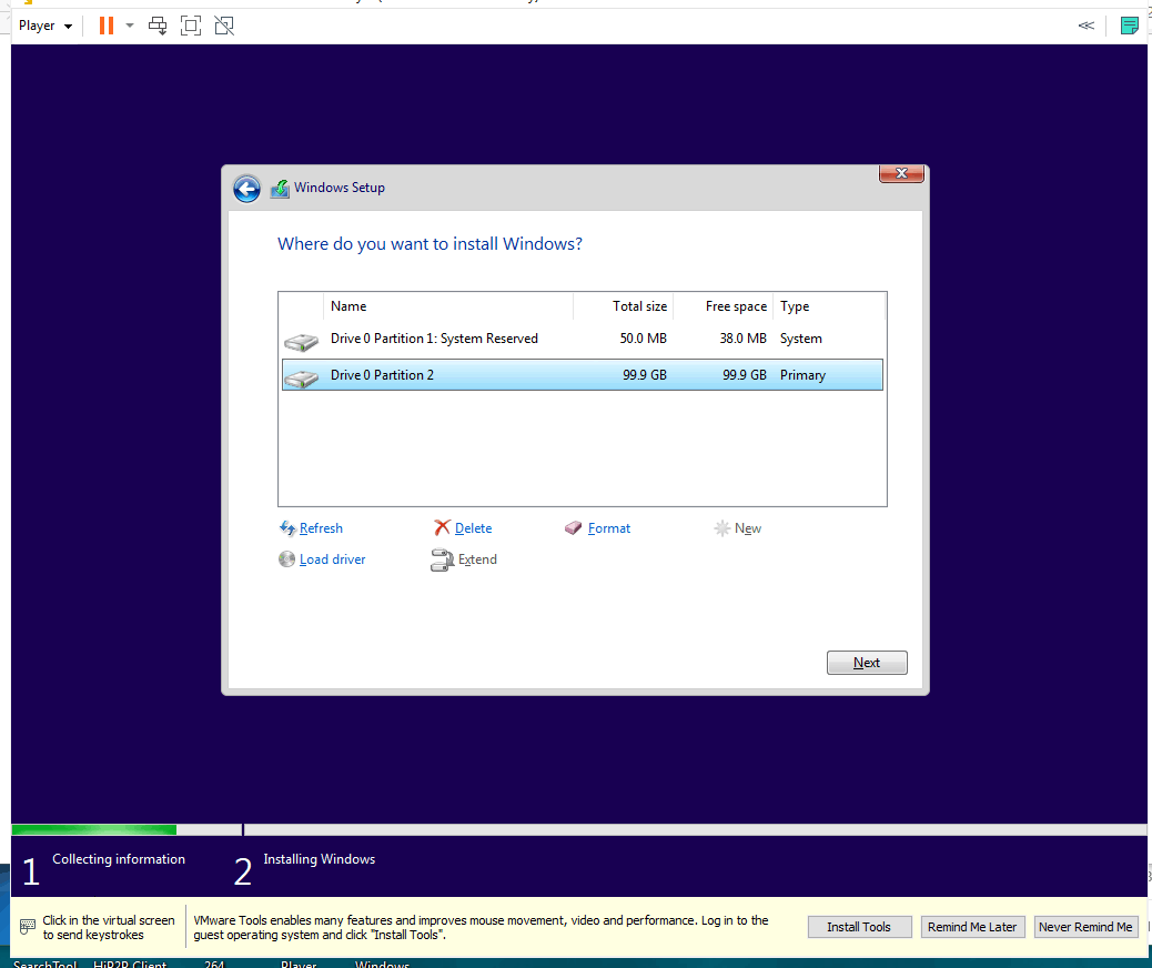

I downloaded and installed VMware Player 16.2.1 and Installed from the MS Insider ISO 22533.1001 on a Virtual machine.
I used the link below to add TPM, then the installation worked all the way through.
How to Enable TPM Support on VMWare Player - Website for Students
Added this line as suggested in the .vmx file:
managedvm.autoAddVTPM = "software"
Cannot go any further, I don't have a key to activate Windows 11 on VM.
Also, way too slow for my taste on this old laptop.

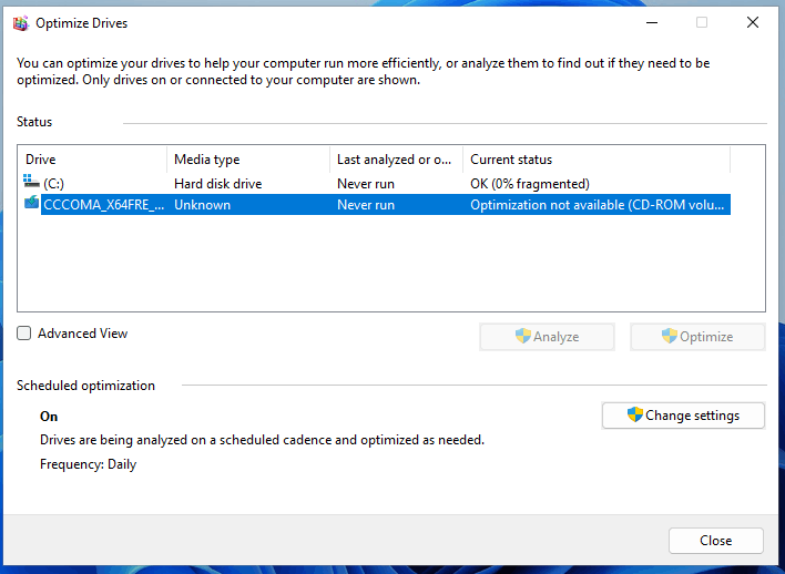

    Basically this is on new system, UEFI. Setup a legacy vm, that boots like normal, but disk optimize not available. This is a W10 Release. Tried this twice with current build custom ISO and also with MS official ISO, same result:

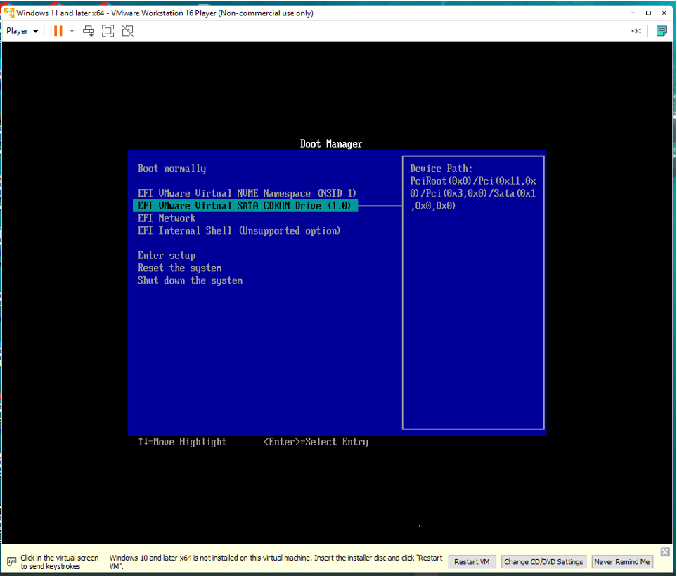

    When I try to boot from a UEFI vm, I keep getting a loop to the boot screen. I always setup vm's to install OS later. I tried using firmware, with vmware pointed to an ISO image, keep getting same loop. Not sure what I am missing. I will get back to you later this week. Need to lay down, not feeling that great. Yesterday was my spouses birthday, making things harder right now.

    As for booting from the ISO it seems a little confusing.

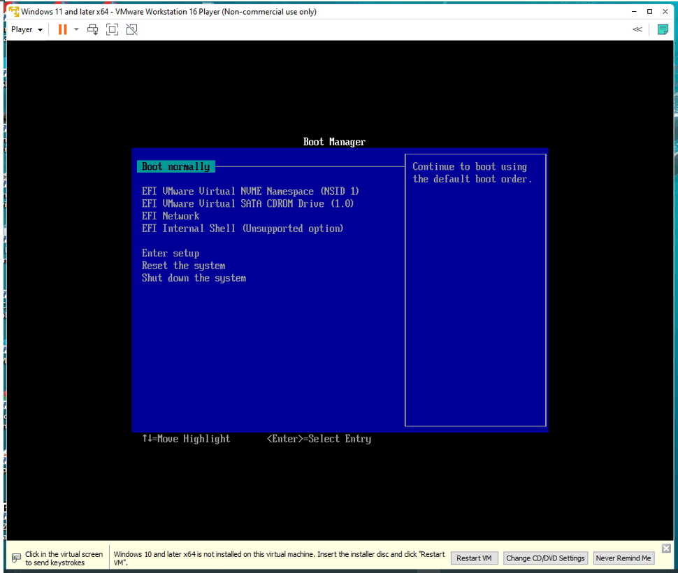

    It comes up with a message to press any key for CD/DVD booting, then it sits on a timeout screen for a few seconds and eventually pops up a booting menu with the selection for the VMware virtual SATA CDROM which I assume is after it mounts the ISO that I selected when I created the Virtual Machine.
    Not quite clear what the logic is. Seems like it tries on a real CD 1st and then goes to Mount the ISO after it times out, then it pops up the menu for the boot selection?

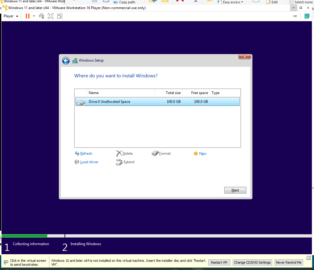

    Gave 100GB when I created the Virtual Machine:

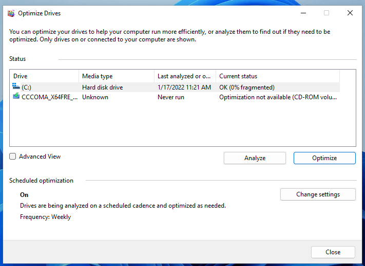

    I reinstalled from ISO 22533.1001, and checked the Optimize, see what it shows below.
    Looks like the Optimize is available for the C: Volume, but clearly not available for the virtual CD, which should not even show up on that screen.

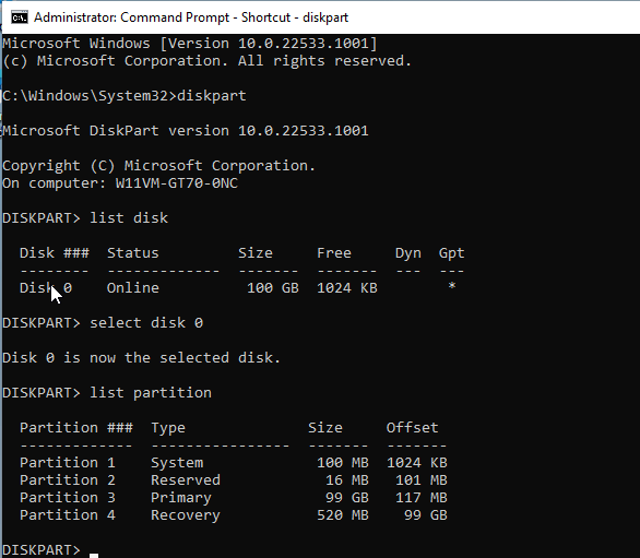

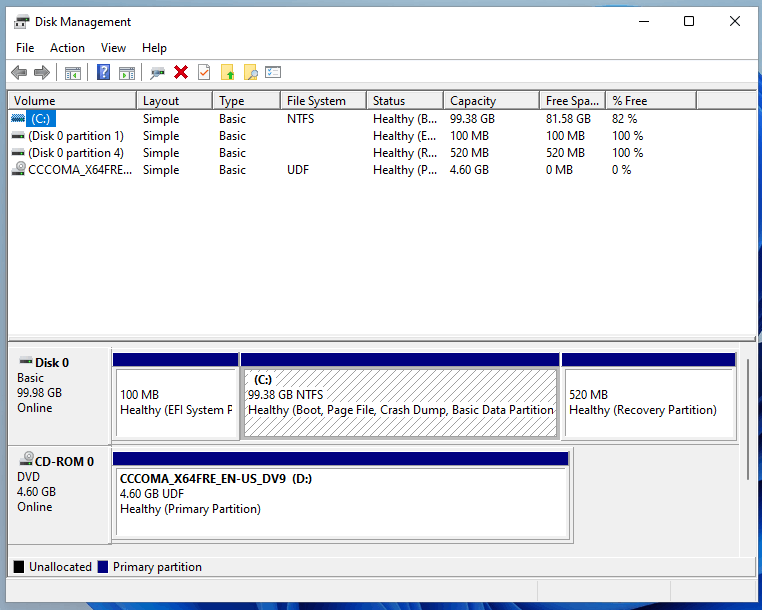

    Look like it does not show the reserved partition, because this is a EFI virtual machine.
    All partitions show up on Diskpart for the Virtual Machine Disk 0.
    Let me know if you want me to check something else.

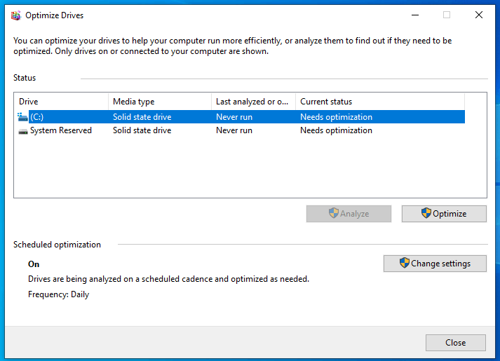

    Found out how to switch to legacy BIOS, I deleted the line on the .vmx file
    firmware = "efi"
    Here I ran Optimize on the VM C: Volume.
    Trying Legacy Bios now:

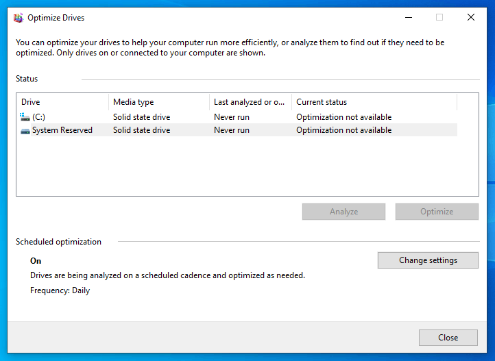

    Hi Sibro,
    I just figured out how to switch a VM to legacy Bios with VM player 16.2.1 by deleting a line on the .vmx file.
    Doing a Legacy Bios Win 10 Install on VM right now, we'll see how that comes up.
    The initial booting from the ISO was immediate without any delay or timeout.
    Edit:
    Windows 10 19044.xxxx on VM Legacy Bios.
    Optimization initially just said "Never run", but when I tried running optimization got the same results as Johnny "Optimization not available".
