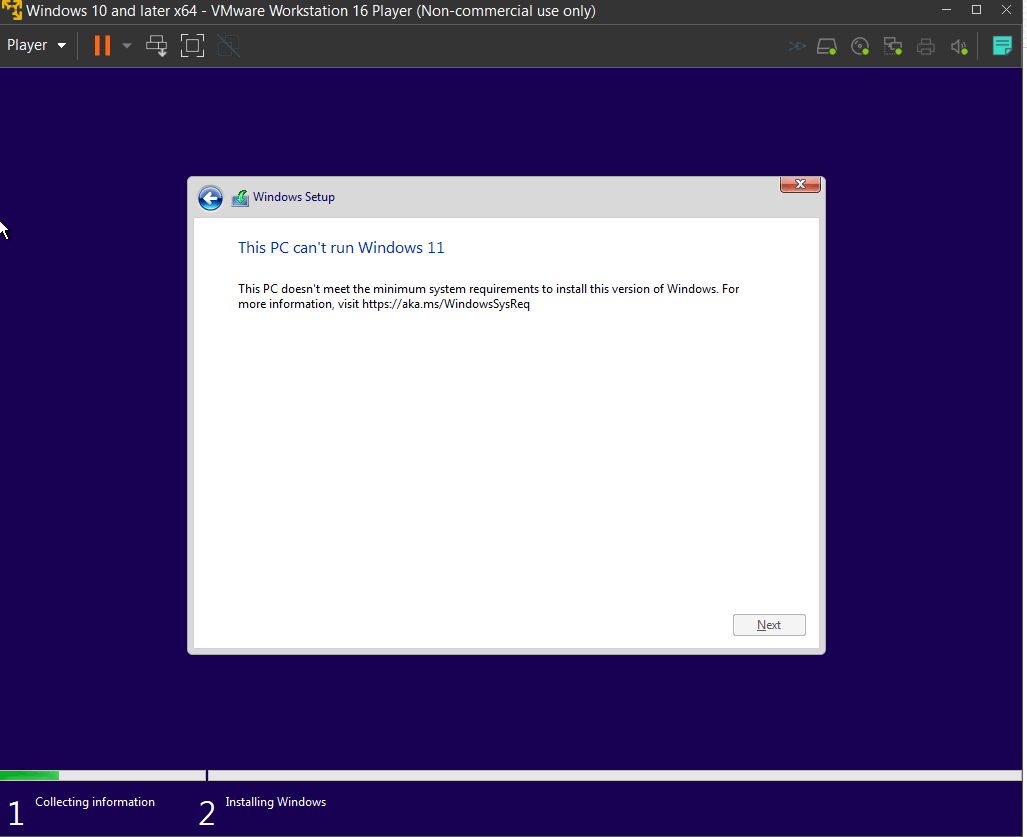

I downloaded and installed VMware Player 16.2.1 and Installed from the MS Insider ISO 22533.1001 on a Virtual machine.
I used the link below to add TPM, then the installation worked all the way through.
How to Enable TPM Support on VMWare Player - Website for Students
Added this line as suggested in the .vmx file:
managedvm.autoAddVTPM = "software"
Cannot go any further, I don't have a key to activate Windows 11 on VM.
Also, way too slow for my taste on this old laptop.

    Can't get it to work on VMware. I did every step and it still does not want to work. When I use managedvm.autoAddVTPM = "software" It says that the .vmx file is corrupt.
    I could be wrong but IIRC, that command doesn't work on VMPlayer
    btw, the correct command line is managedvm.autoAddVTPM="software" no espaces,
    maybe that is why it doesn't work.

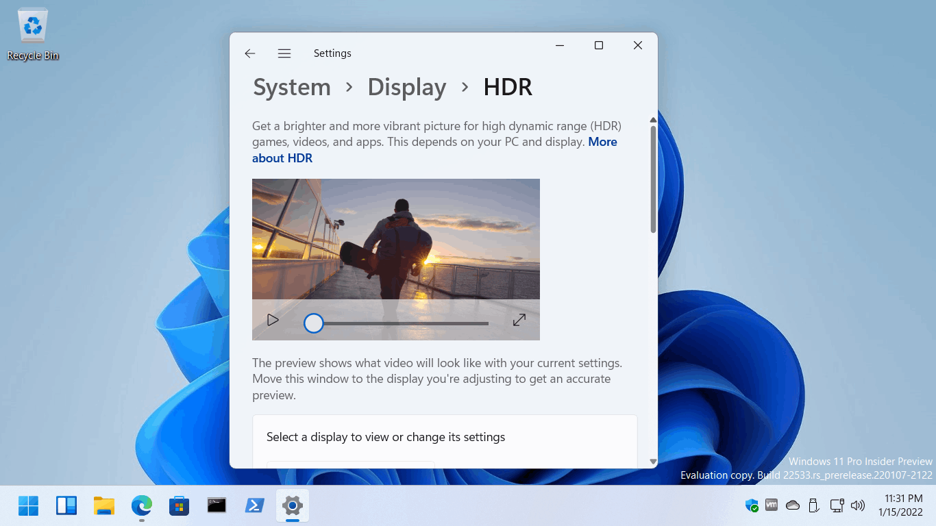

    Good Morning Sibro,
    Thanks. I have no idea why I was getting that loop previously. I did same thing as always, mount ISO, on UEFI boot screen used cdrom, this time it worked. Possibly just a bad install of VMware program itself the first time. I completely removed it, waited must be close to week, re-installed with newer version. I used the following for W11 vm's in VMware vmx file (hated those passwords):
    Instead of encrypting and adding the TPM, just add this VMX flag instead:
    It only encrypts enough for the "secure enclave", so perf should be way better, & no pwd
