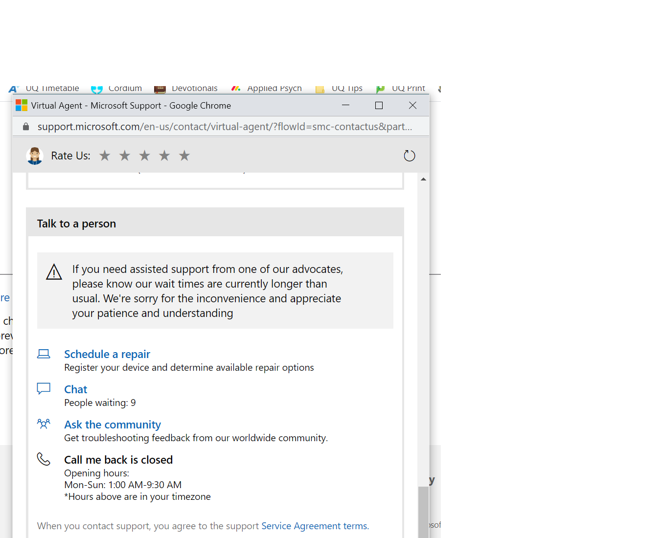

    Have had the exact same problem - first 2 weeks of having it was fine, but for the last 3 weeks, I could not use it at all. Whenever I was charging the laptop I could not use it due to the overheating and freezing. This is a major issue and I am gonna ask for a refund. Also, call me back for Australia is 1am to 9.30am! How ridiculous is that? That is horrible.

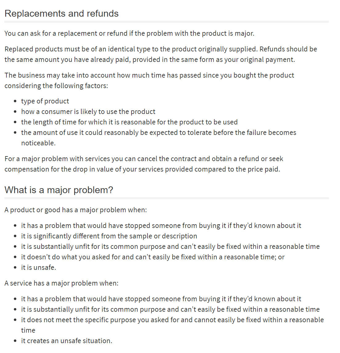

    Here is an info from Aus Consumer Law website
