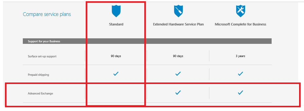

    I finally got to talk to someone after waiting on hold for 1.5 hours. All the agent did was send me two email messages. One message contained the chart below showing that we are not entitled to Advance Exchange because we didn't pay for extended warranty coverage. I asked the agent why I have been allowed advance exchanges, and she offered me no explanation, she just reiterated that I don't have the option for advance exchange. The other email was a form to fill out to get my exchanges processed. I asked her if I could just fill out the form and email when new issues arise. She told me I can't; I must call every time.
