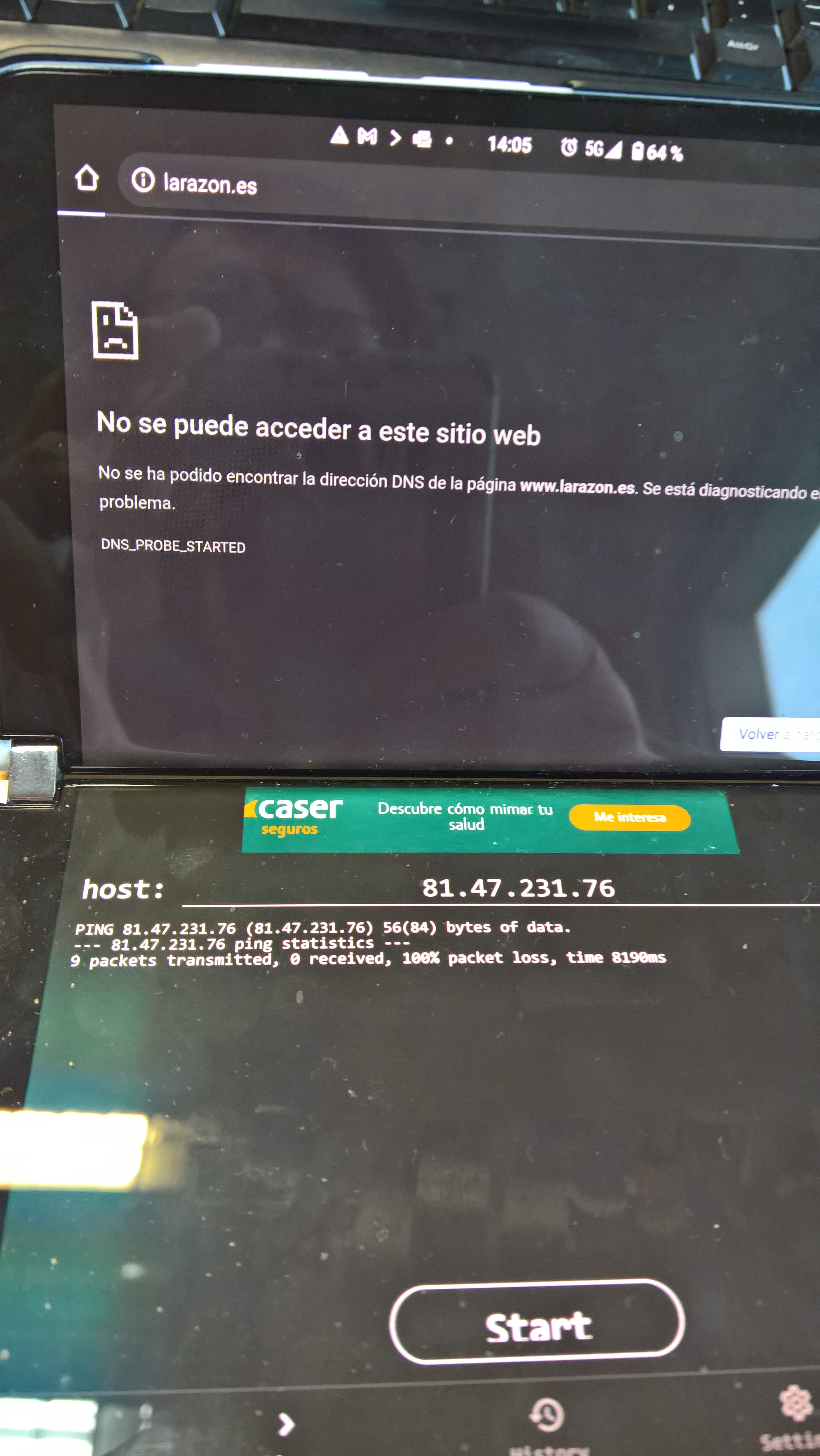

    Duo 2 screen with blocked browser trying to access a popular newspaper, in theory signal level very OK, in the other screen I run pings and it can be seen that there are random errors (here 100% errors in the first 10 tries prevented ping to start). When there are Internet blocks, there are delays and ping errors and vv.

    The issue does no depend on which browser to use, as there are reception errors. I though it could be an Internet / APN issue but for my desperation I am starting to think that it can only be only a HW problem (either processor or antenna) (as thinking of the OS is nonsense in this case)
