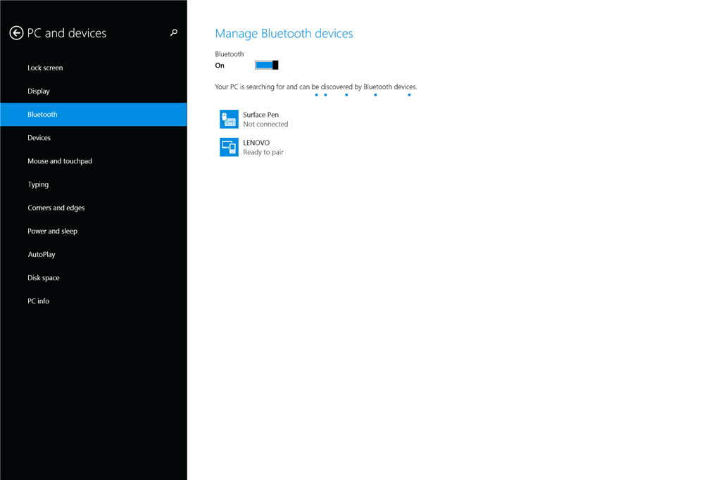

Furthermore, when I look at the Bluetooth settings screen it looks to me like everything is working fine.  Usually the Pen is "Not Connected" but it's showing up on the list since I paired it.  When I click the big purple OneNote button on the pen, the "Not Connected" message goes away.  It doesn't explicitly say it's connected, but the Surface Pro 3 is clearly recognizing the activity at least and it seems like it's connected (no error messages or indications of problems).  Sometimes when I press the button, instead of the "Not Connected" just changing to blank, it'll show a brief loading bar first and then look just the same (blank, without the "Not Connected" message).  Either way, the "Not Connected" message comes back after about 5 seconds, which seems reasonable if it's connecting and then disconnecting to save power.  So I interpret that (perhaps incorrectly) as it's able to connect via Bluetooth.

    By the way the pen should stay disconnected the whole time and only connect whenever you click in the top button.
    Yes, that's what I'm observing.
    It usually looks like this:
    Then, when I press the pen button (on this screen so I can get the screenshot), nothing opens but the "Not connected" goes away as follows:
    After 3-5 seconds, it goes back to the first image ("Not connected").
    This leads me to hypothesize it's working properly on the Pen side and it's something with Windows/drivers/etc. that may need fixed, particularly around whatever should be recognizing the button press and triggering OneNote to open.
