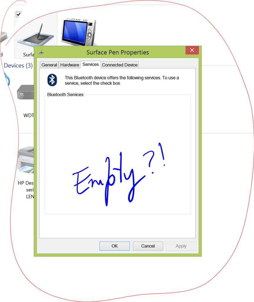

    Guessing, I'm assuming this is a Bluetooth event since it triggers Bluetooth with no issues..  I found Bluetooth services, but they were blank.  I didn't think to look after my Factory reset...not worth another reset to find this out....
    Where did you find the BT Services? I can look and tell you what I see there.
    I found it in Control Panel, Hardware and Sound, Devices and Printers, Surface Pen.  Right mouse click, properties, Services tab.  I went looking in the Registry also, but am pretty sure I have no clue as to what I'm looking for ....yet.
    Thanks...I'll find it somewhere....this was a guess....thanks for checking....
