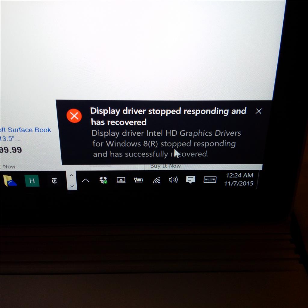

    2015-11-07T08:42:35+00:00
    Hi I is a mechanical and software issue   MS tech support replaced it this morning by finding me one tucked away at a local MS store   this one is working great not error free however  the latch works perfectly though I noticed it does not unlatch when you are on any SETTINGS page   I also got this error in the photo tech Support told me this is not a huge issue but will be fixed in an update   with the Graphics crashing and recovering Tech support ran extesnive Tools diagnstics on two of my S Books that have since been sent back to theor team as defective but when they ran the elaborate Intel test and NVIDIA test even the,se two defective Books came back as working perfectly as far as those two all important chips are concerned   so the conclusion is that except: for the me,chanical failure of the latching system in the tablet, all these other issues are software related and or there are conflicts with apps conflictibg with the system
