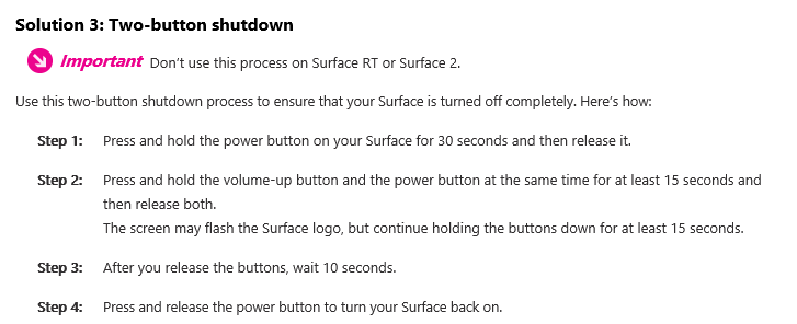

    One of our Surface Books had the same issue.  Confirmed that Power + Volume Up for 15 seconds does fix it.  You'll see the detach light up briefly during the process.

    Did the steps Fatou8 provide not resolve?  I'm particularly interested in knowing that if after installing updates, completing a two-button shutdown failed to resolve as well (steps below).
    After completing a two-button shutdown you may need to charge your battery - detach requires both Battery One and Battery Two to have at least 10% charge.
    Let us know how it goes.
