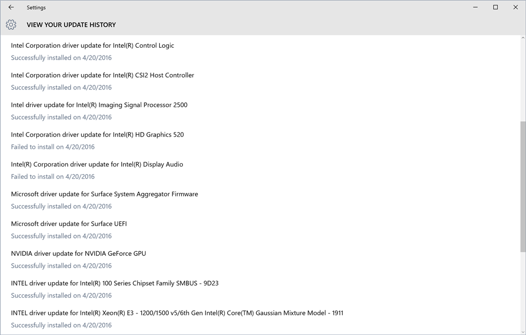

    Not suggesting anyone do this, but I used the Reset this PC option to do a full wipe of the system. Once installation completed, I ran Windows Update and most of the drivers installed and the system updates completed successfully.
    All I see now are the following errors:
