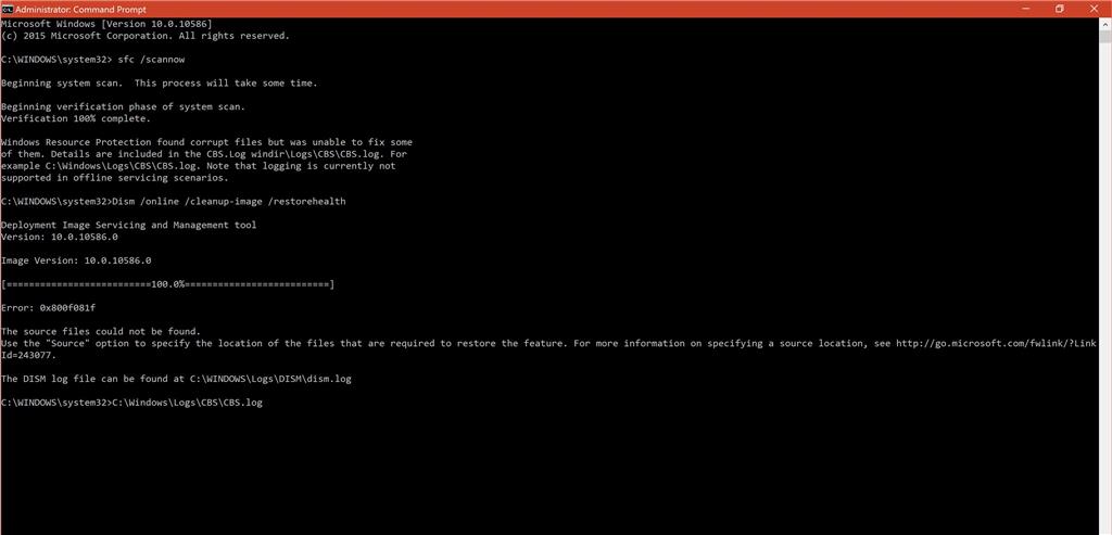

    Well, I did as Matt’s post suggested:
    1. Right-click on the Windows Start logo > COMMAND PROMPT (ADMIN)
    2. Entered this code where the cursor is flashing:  sfc /scannow(Came back with errors that could not be fixed.)
    3. Entered Dism /Online /Cleanup-Image /RestoreHealth(Came back with Error code:  0x800f081f)
    This is where I am... I'm not particularly happy or comfortable that I have to do this. But I guess I'll continue on with the other steps. I'll post again to let you know how it turned out.

    6. Entered this code where the cursor is flashing:  sfc /scannow (Came back with errors that could not be fixed.)
    7. Entered Dism /Online /Cleanup-Image /RestoreHealth(Came back with Error code:  0x800f081f)
