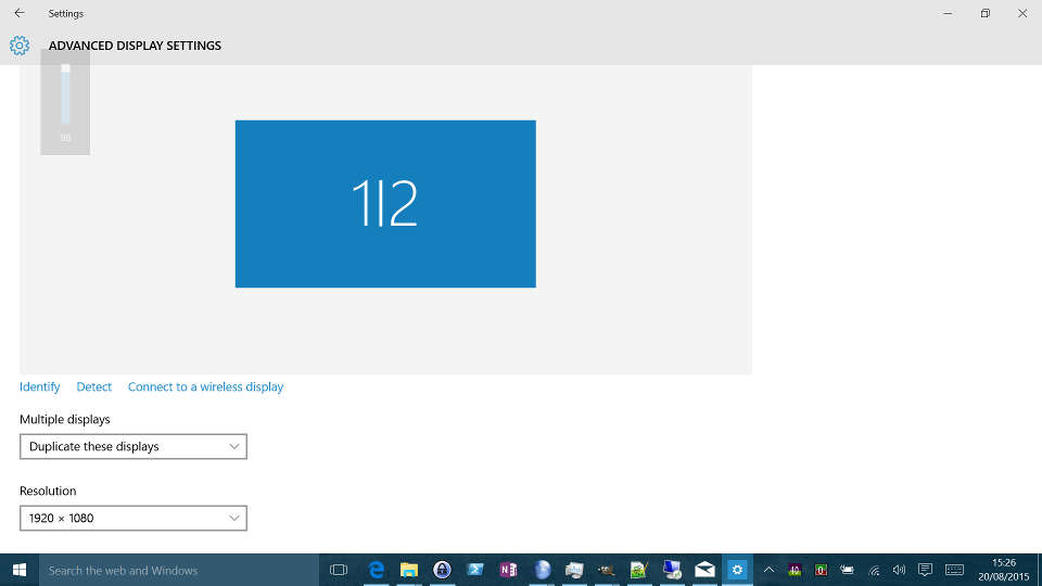

    2015-08-20T14:30:22+00:00
    For me this is finally fixed in Windows 10 using the 19 August update (http://www.pauby.com/blog/surface-pro-3-graphics-update-improves-performance-stability-under-windows-10/)
    What I'm using:
    • Screen mirroring / duplicate for the MWDA;
    • A Logitech Bluetooth mouse connected;
    • Logitech Bluetooth keyboard connected (which I'm using to write this on now);
    When I initially connected the resolution on my Surface stayed at 2160 x 1440 even though the TV can't display that resolution. However it did show the screen in a box so it was obviously scaling it. Changed the resolution down to 1920 x 1080 and the TV screen showed it correctly (although a bit of chopping at top and bottom). Each connection since has connected at 1920 x 1080 and changed the resolution on the Surface to match.
    Picture below confirms this.
    The only issue I am left with is the dreadful lag that now exists which I didn't have previously (albeit at the wrong resolution).
