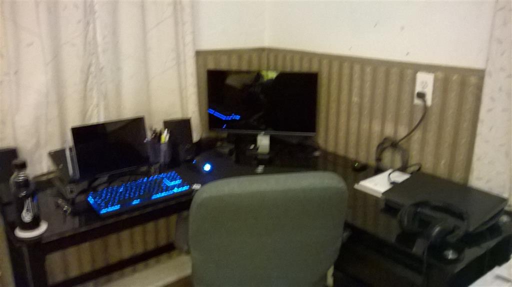

    Cool setup 😊. I do not experience any problem with the System interrupts exe. I think that many Windows RT users who download whatever pdf files on their devices can also be impacted by this, leading to a horrible experience and inability to propel the Windows 8 experience into unparalleled productivity scenarios.
    Michael
