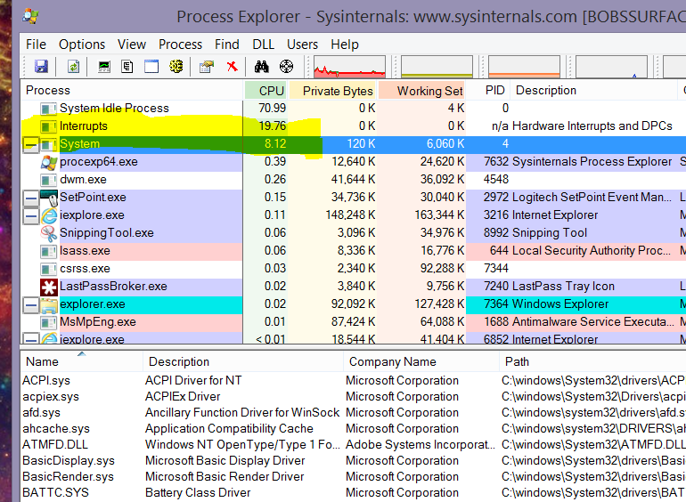

Oh!! I just checked it again as I wanted to make a screenshot and now it's working! I don't know what changed. The only thing I did was that I originally enabled Hyper-V but when it started interfering with my WiFi connectivity I disabled it again, so maybe that's what was necessary.. I used to have constant high "System Interrupts" process running, but disabling one by one I found out that an Adobe startup process was causing it, so I disabled it and it seems to have fixed the issue. Either way, thanks for your responses!

    I believe I found a work around. Is not a complete fix but is a work around that may fix it. I am testing but would like to see if some other people from this forum can test this work around.
    This may fix the system/systems interrupt issue with the realtek. But of course at a price. Thats why it is a work around.
    By doing this you may not be able to use your build in microphone on the surface. If you are a person that use skype or other application that requires the microphone this work around may not work for you unless you want to return your settings the way it was.
    Not sure if this option appears with the original surface audio driver...im using the latest one from Realtek website.
    Here it goes:
    1. Right Click on your speaker icon on the system tray...right beside the clock.
    2. Choose recording devices.
    3. Select with your mouse the Microphone (Realtek High Definition Audio) and click on Properties.
    1. Click on the "Listen" Tab.
    2. Mark the option that says Listen to this device.
    3. In playback through this device...select Default Playback Device.
    4. Then this step is really important...Click on the "Levels" Tab.
    5. Turn the volume level of the microphone to 0 and Mute the microphone as well.
    6. Turn to the microphone Boost to 0 as well.
    Click apply...and you are done.
    For some reason the issue with the systems/systems interrupt goes away when the microphone is in use. When you click the Listen option the microphone is already listening to something (in this case the default playback device) but because is in mute is not listening to anything.
    Note...if you dont turn down the volume of the microphone or mute and you play something loud you are going to hear some feed back.
    If you are going to use your built in microphone you may need to uncheck the "Listen to this device" and turn the volume up of the microphone.
    I hardly ever use the microphone in the surface...i prefer to have a cooler machine with better battery life than using the microphone.
    Because this issue is sometimes hard to replicate I encourage other people to see if this method helps you.
    Still hope that Microsoft finds a TRUE fix for this.
