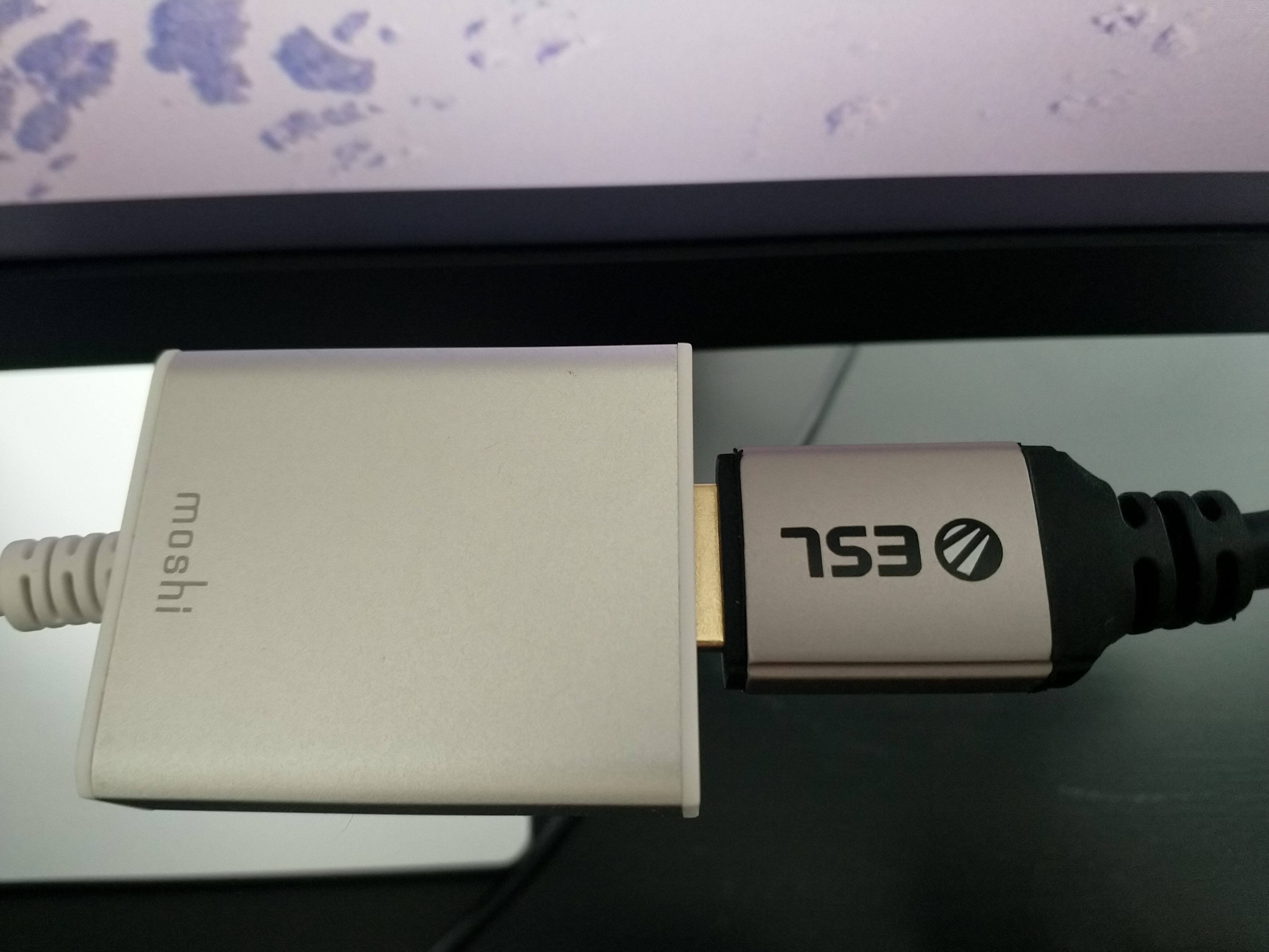

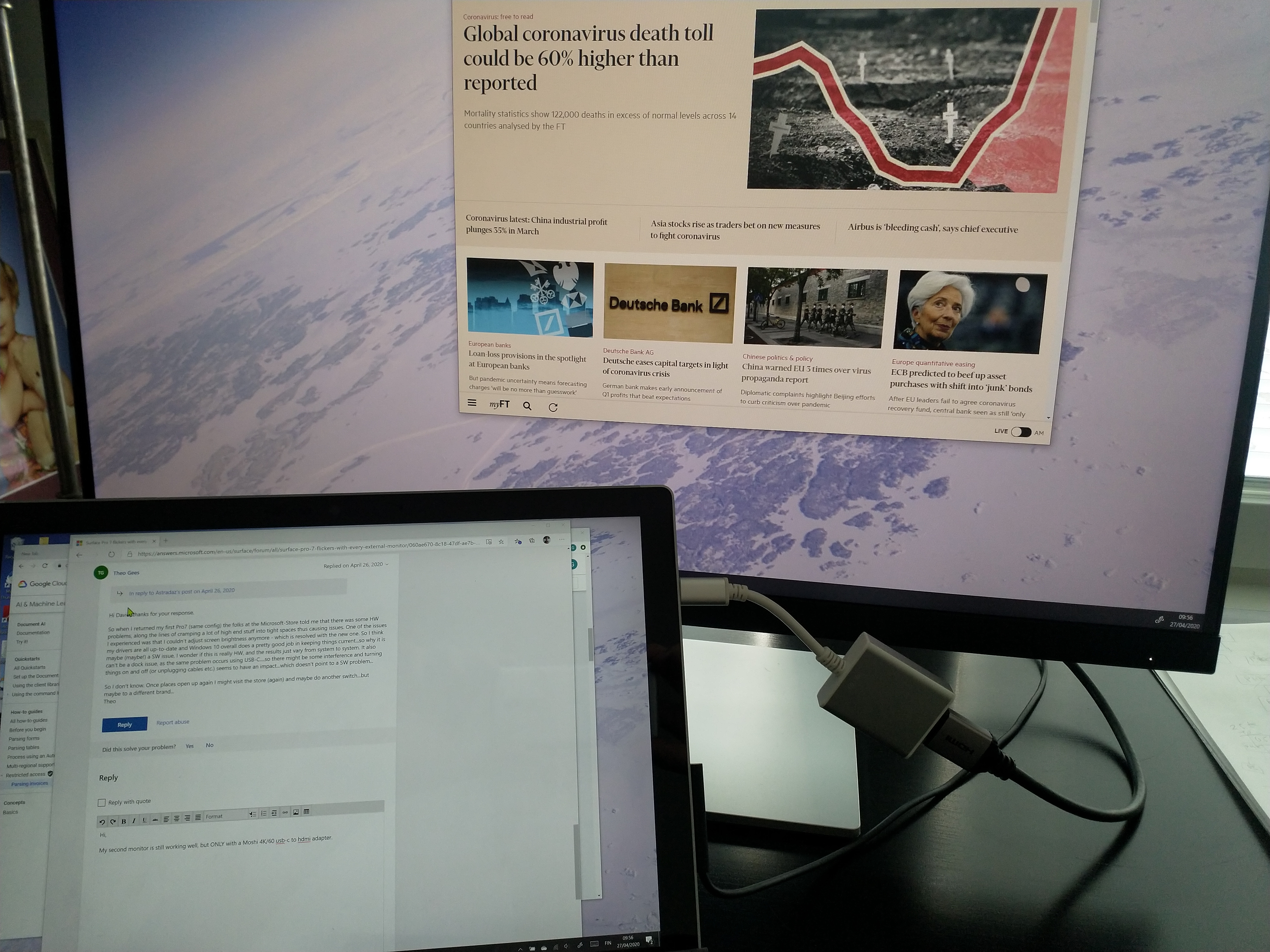

    My second monitor is still working well, but ONLY with a Moshi 4K/60 usb-c to hdmi adapter.
    I wish somebody at MS could tell me why only the Moshi adapter works.
    Even the MS usbc-c to hdmi adapter does not work.
