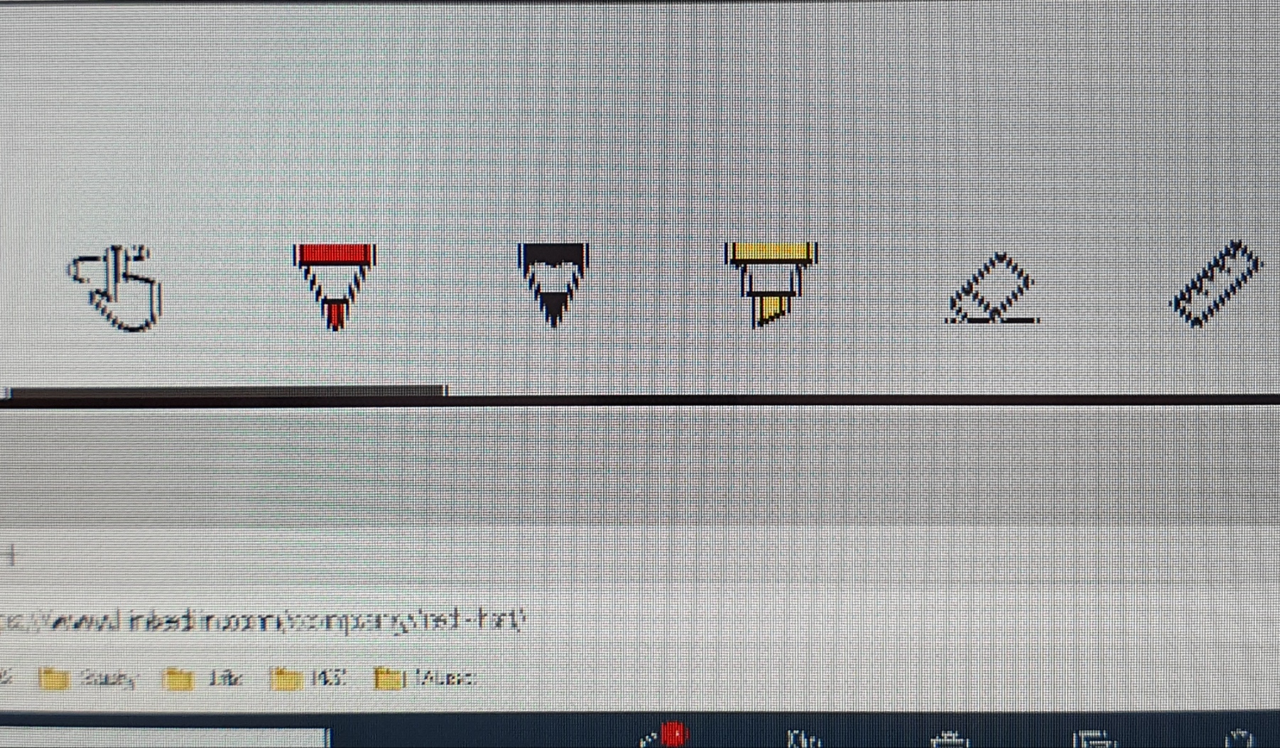

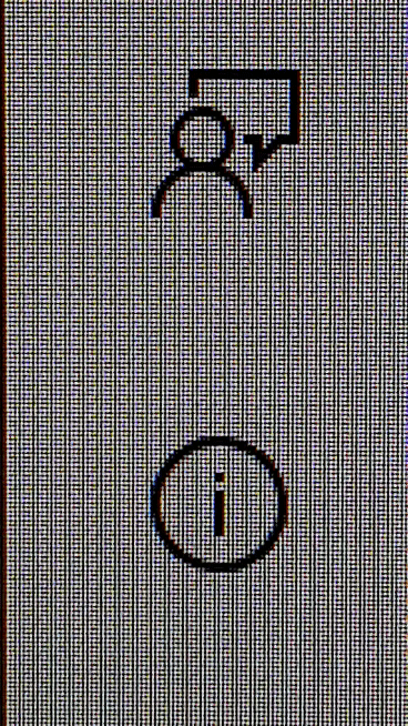

When I connect an external display while the Surface is already turned on, the external display is flickering. When I restart the Surface with the external monitor already attached everything works fine. Disconnecting the Surface then and reconnecting
  • same problem. The flickering appears with different monitors, different cables and with different connectors (Surface Dock or USB-C). I have the 16 GB, i7 Version of the Surface 7 with an up to date OS.

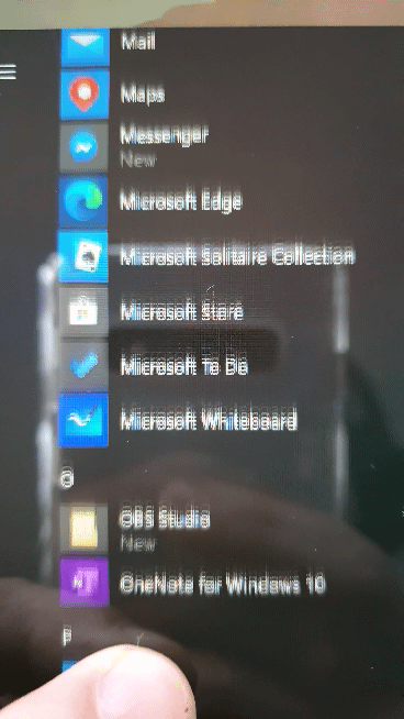

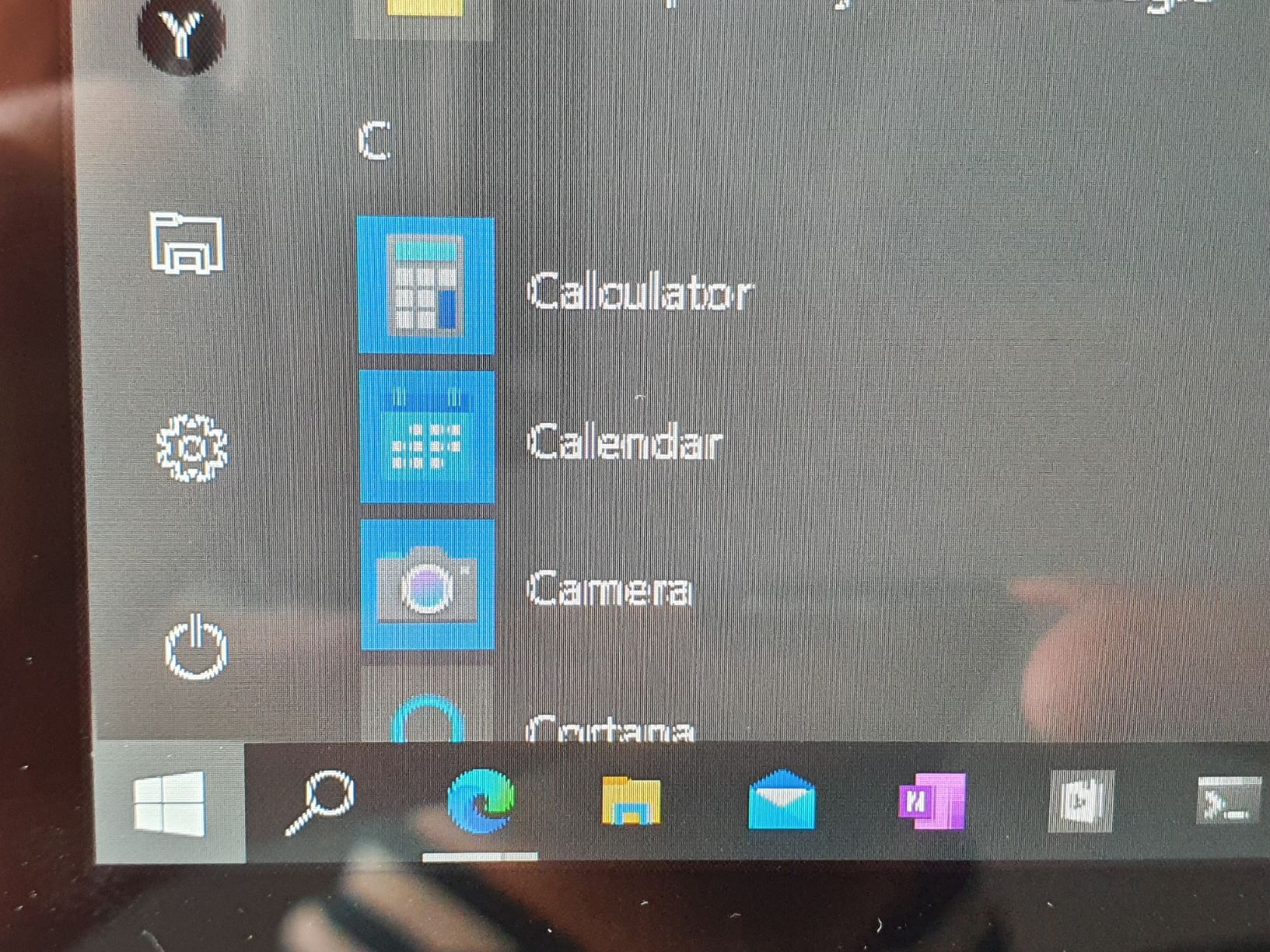

    I have some issue before update to version 2004. I had a Apple USB C adapter plug to TV to watch Netflix near after an hours TV screen has flicker, but it's happened very randomly.
    Today, I got anther flicker issue from Surface Pro 7 itself. I tried reinstall display driver, upgrade to latest windows with no luck. I did force shutdown and I works ok now. I guess it's Intel driver issue between display and chips.
