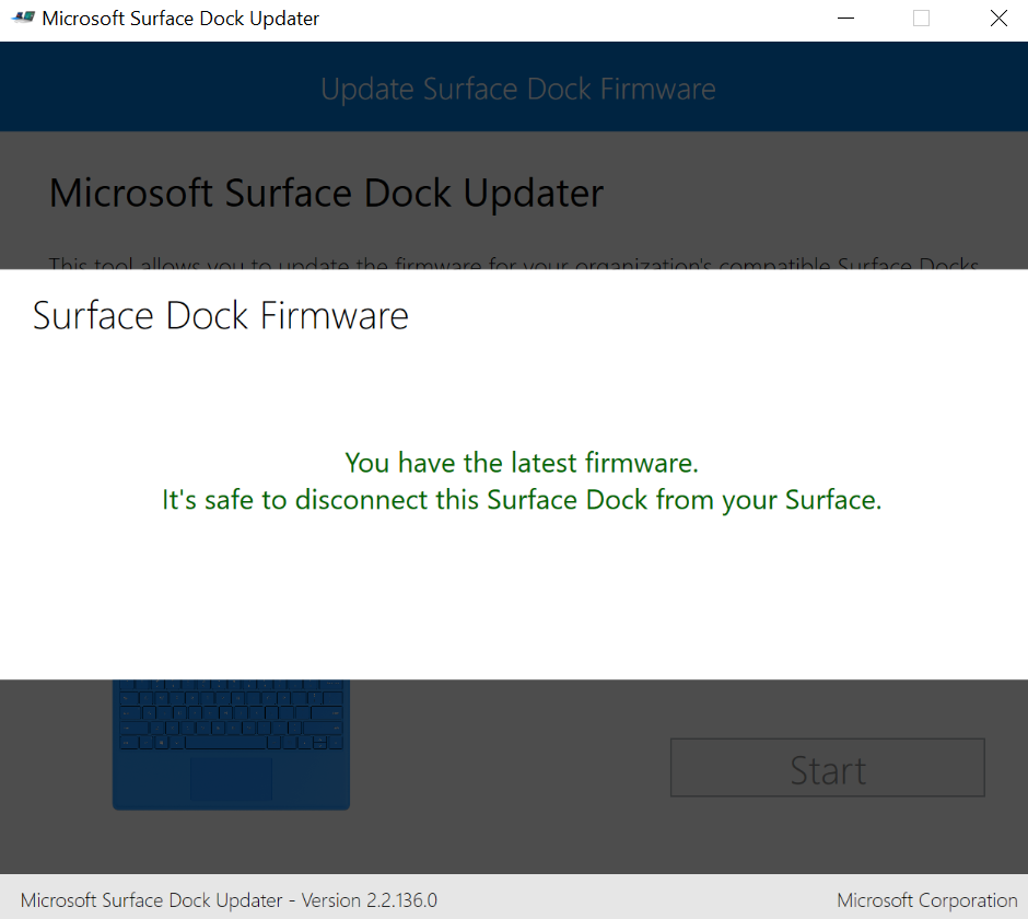

My monitor (LG 29UM68) is connected to Surface Dock -> SP4, via direct miniDisplayPort.
It keeps entering sleep mode and waking up repeatedly, even though my SP4 is asleep. This does not happen when I connect the monitor to SP4 directly.
Another issue is that if I set to PC Screen Only, after few seconds, it will automatically switch back to external monitor only. Again, this does not happen if I connect monitor to SP4 directly.
These 2 issues only arise if I use Surface Dock.
I have gone through all the steps here (https://www.microsoft.com/surface/en-sg/support/hardware-and-drivers/troubleshoot-docking-station-surface-dock) successfully, but issue persist.
Please help.

    I have been fighting this issue for some time, with a Surface Dock and now a Surface Laptop. Doing my homework, updating firmware, on the phone with Microsoft, wait for a replacement.... Yes, the whole process you all know the pain of.
    But now FIXED because of this thread!
    THANKS TO ALL OF THE MEMBERS
    Well, as Michael said in the last post, not fixed, but I will take the workaround.
    I picked up an active MiniDP to HDMI 4k adapter and a good HDMI cable and it now works as I expected it to. My external Samsung 4k monitor shuts and stays off properly when the Surface Laptop is in sleep/hibernate/off mode. Plus I got a huge benefit from adding the 4k adapter:  The monitor resolution now goes to 3840 x 2160. Nice and clear. Could never get that resolution before. What a difference.
