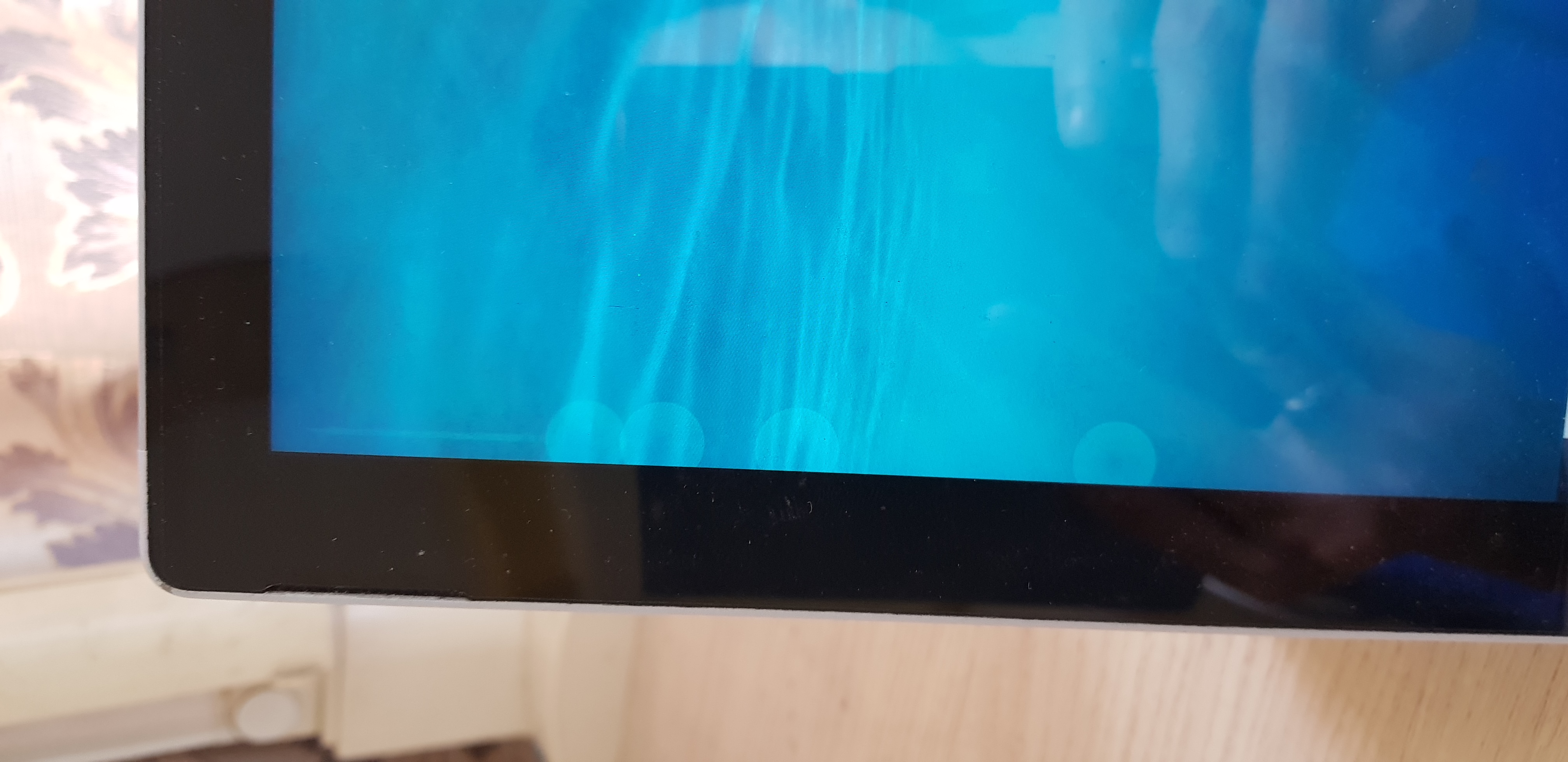

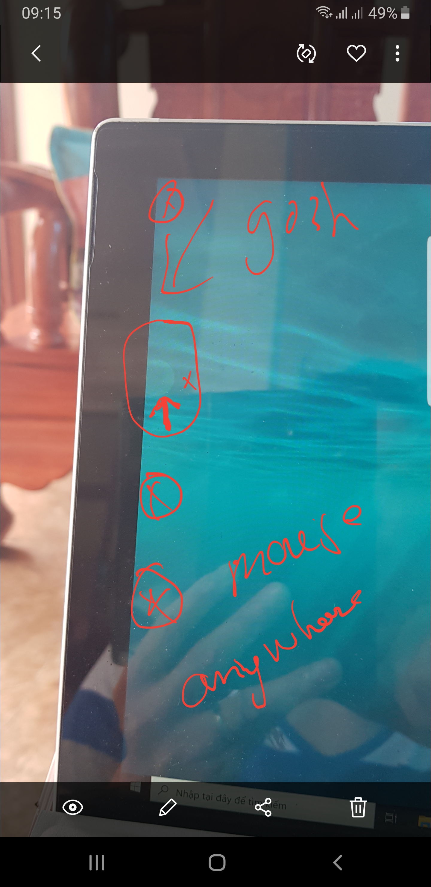

    Sp3 with windows 8.1 and windows 10 pro, its ok. But when, update win 10 v 1806 and 1903. Display as picture, w8th many circles and touchpad dance anywhere.
    Check firmware touchpad: N-trig 15/5/2014. UEFI 14/6/2018
    And when restart, code 10 or 14 with logo surface.

    2019-06-21T02:16:10+00:00
    Hi all
    I RUN CLibG4, however. Nothing to Fix
    Please help me.
