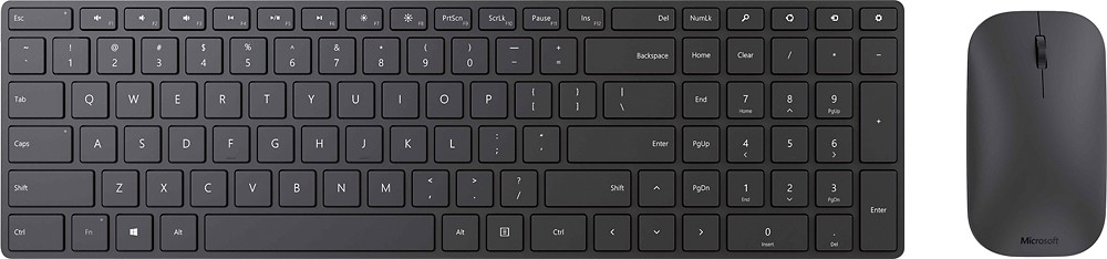

    This is the keyboard i am using
    These are the same keyboard and mouse I used on my previous Surface Pro 4 without any problem.
    I have tried the pictured mouse as well and get the same problem.

    Thanks for sharing the photos. It is the Microsoft Designer Bluetooth Desktop Mouse and Keyboard and this really seems to be a compatibility issue because you already installed the latest Bluetooth drivers and the Surface Laptop 3 has Bluetooth 5.0 technology while the Surface Pro 4 you had (without getting any trouble with these accessories) has Bluetooth 4.0 connection interface. I also re-confirmed that the Wireless Arc Mouse is  perfectly compatible with Bluetooth 4.0 enabled devices.
