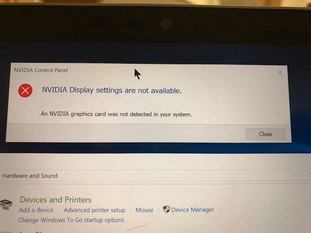

Hello MS support,
I bought surface book 2, 256 GB, NVIDIA GeForce 1050, 2GB model  in November, 2017 and it worked pretty well until recently. I don't know why it stopped detecting the GPU. It's not showing up in the display adapters. I tried detaching and attaching the screen it gets detected for a moment and goes off again. I tried one solution offered in the Microsoft page to uninstall the driver (checking the delete software ) and restart the PC but with no luck.
Is it a hardware problem or a frequent software problem ? I will be really glad if you can provide me a solution to this.
Thanks,
Rajeev
