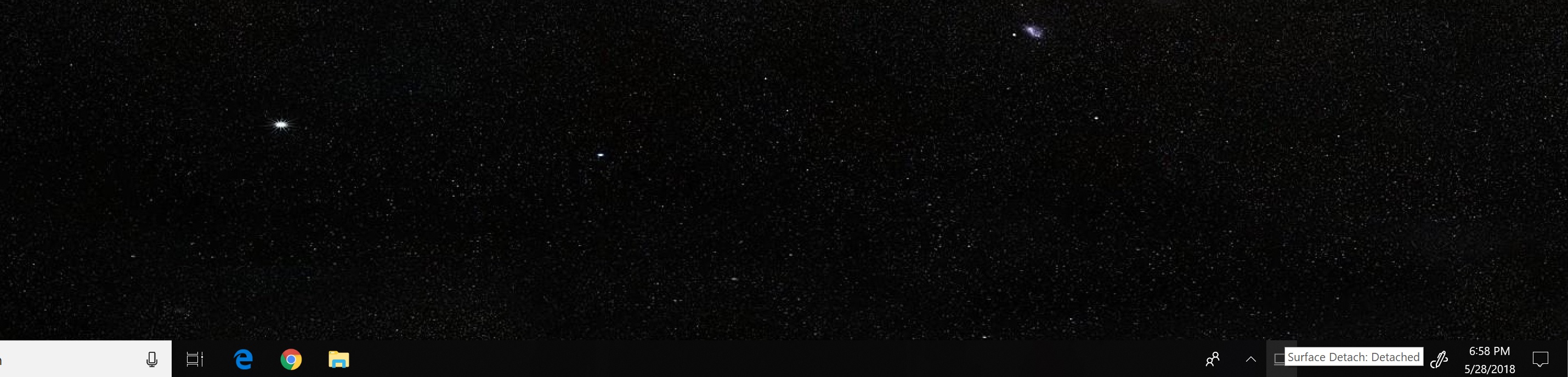

    Thank you. The method you describe is not working for me. This may be unrelated to your specific issue but I think the problem has to do with the latching system rather than the video card drivers. Each time that my DGPU is undetected I notice that my surface thinks that the tablet is detached. Sometimes this results in a "General Failure" with the latching hardware and I have to try and detach the table somehow. If I can successfully get the surface to recognize that the tablet is attached then my DGPU is detected and it works fine but if I try to do the UEFI reset at this point it so far restarts with the hardware failure once again. Does your SB have any similar symptoms?
