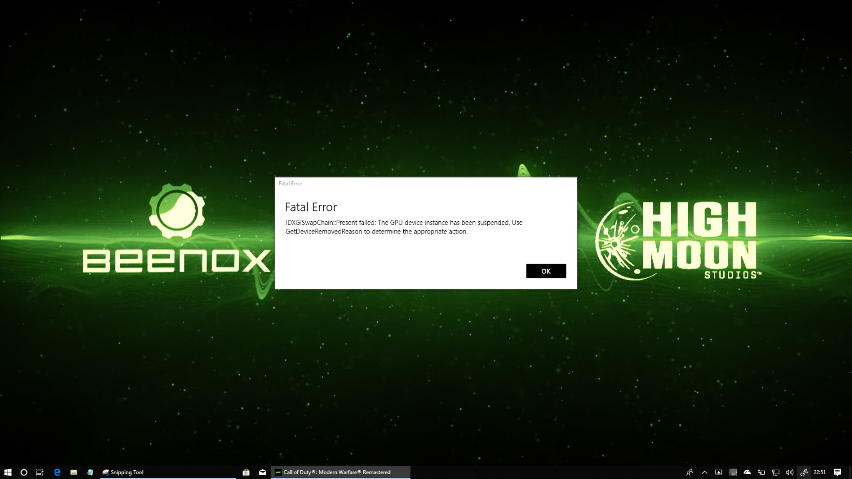

    2018-08-02T06:02:25+00:00
    Anyone else ever get a message like this trying to play a game on their Surface Book 2?
