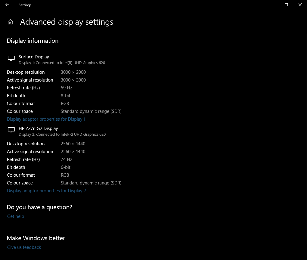

    After this update, my external monitor is now set to a Bit Depth of 6-bit rather than 8-bit which results in severe colour banding.
    I can't find a way to change it, will try to rollback the update later today.
    I'd rather have to go through a forced restart every few months then have a terrible looking image on my monitor.
