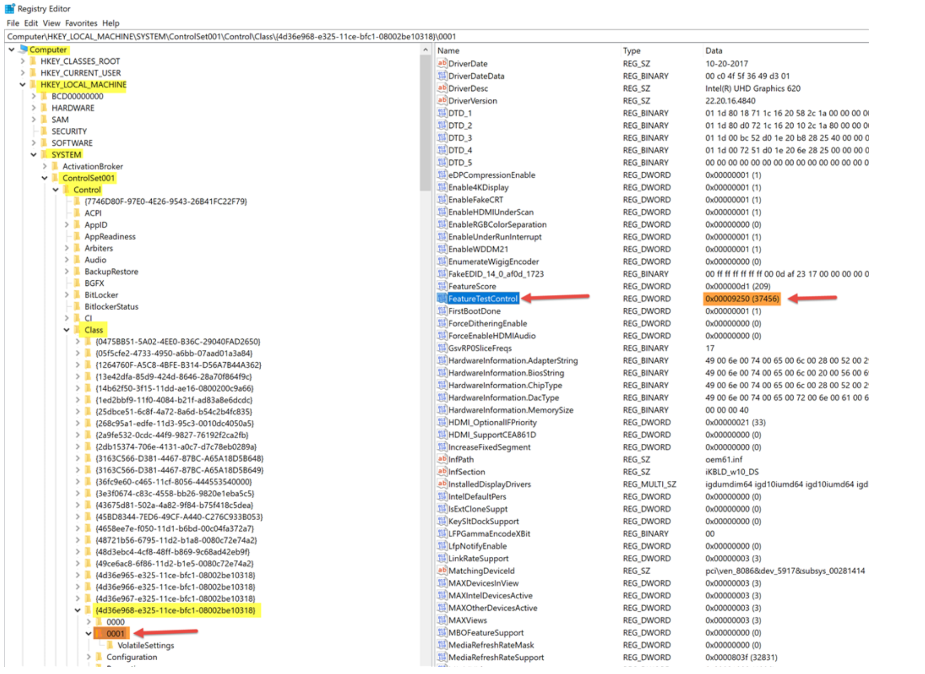

This clearly works with Surface Book 2. I don't know if it will work for other surface devices but if you have this registry entry, you can try making the change. The step to fix is as follows:
  1. Open up Regedit (to edit registry)
  2. Backup your registry before making the change - Once in Regedit, Right-Click on Computer, then Export to backup file, can put on desktop...
  3. In the image below, it shows you where the registry entry is. You need to find this, locate the "FeatureTestControl" entry where the image shows you to find it. The value for FeatureTestControl should show: 0x00009240. Right-Click on this entry and modify binary, change the 40 to 50. Then exit registry.
Note, as indicated on left side, I had to select 0001. If for some reason you don't see FeatureTraceControl there, you could check 0000 just above 0001. Again, I saw it at entry 0000.
  1. Once you have exited registry, Reboot system
Again, this worked for me and hopefully for you.
