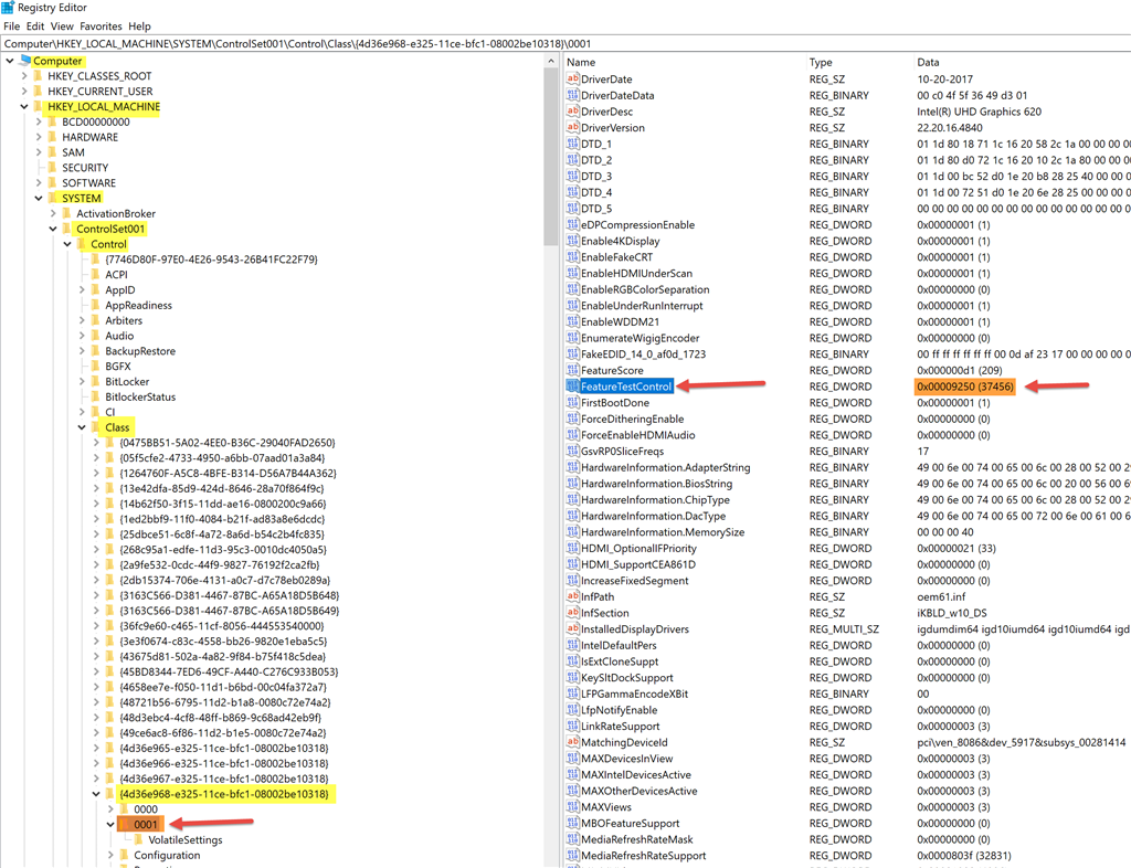

Over the past couple of weeks I have been working with Microsoft Tech Support (who was interfacing with MS Engineering). Today, I spent some time with tech support testing out a possible fix for this issue. I am VERY PLEASED to report, it appears they have given me a fix that WORKS!!!!!
The fix is a very simple registry setting. I have been playing with things since making the change and have not seen the issue anymore...
This clearly works with Surface Book 2. I don't know if it will work for other surface devices but if you have this registry entry, you can try making the change. The step to fix is as follows:
  1. Open up Regedit (to edit registry)
  2. Backup your registry before making the change - Once in Regedit, Right-Click on Computer, then Export to backup file, can put on desktop...
  3. In the image below, it shows you where the registry entry is. You need to find this, locate the "FeatureTestControl" entry where the image shows you to find it. The value for FeatureTestControl should show: 0x00009240. Right-Click on this entry and modify binary, change the 40 to 50. Then exit registry.
Note, as indicated on left side, I had to select 0001. If for some reason you don't see FeatureTraceControl there, you could check 0000 just above 0001. Again, I saw it at entry 0000.
  1. Once you have exited registry, Reboot system
Again, this worked for me and hopefully for you.

    2018-12-05T01:32:16+00:00
    The same thing is happening to me
     I closed the screen energy-saving technology by manually installing the intel driver from the device manager, which solved the problem of brightness flicker.
    1.Download intel driver ZIP and unzip it
    2.open "Device Manger"-->"Display adapters"-->right click Intel Graphics card into Properties
    3.select second option "Browse my computer for driver software"
    4.Browse and select the unzipped folder(mine is D:\Intel\Graphics)
    (OR select Let me pick from a list... then click Have Diskand Browse... the unzipped folder( D:\Intel\Graphics) select igdlh64.inf)
