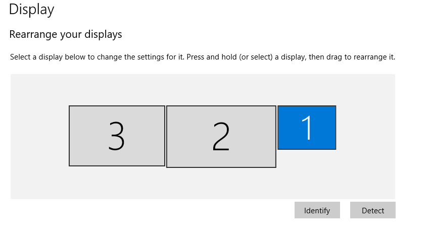

    Here's the configuration that worked for me...
    1. USB-C to Display Port Adapter
    2. USB-C to HDMI Adapter
    #1 connected to USB-C on Surface Dock Pro 2
    #2 connected directly to USB-C on SurfacePro 7
    Set SurfacePro Display settings as shown and Disable the computer display.
