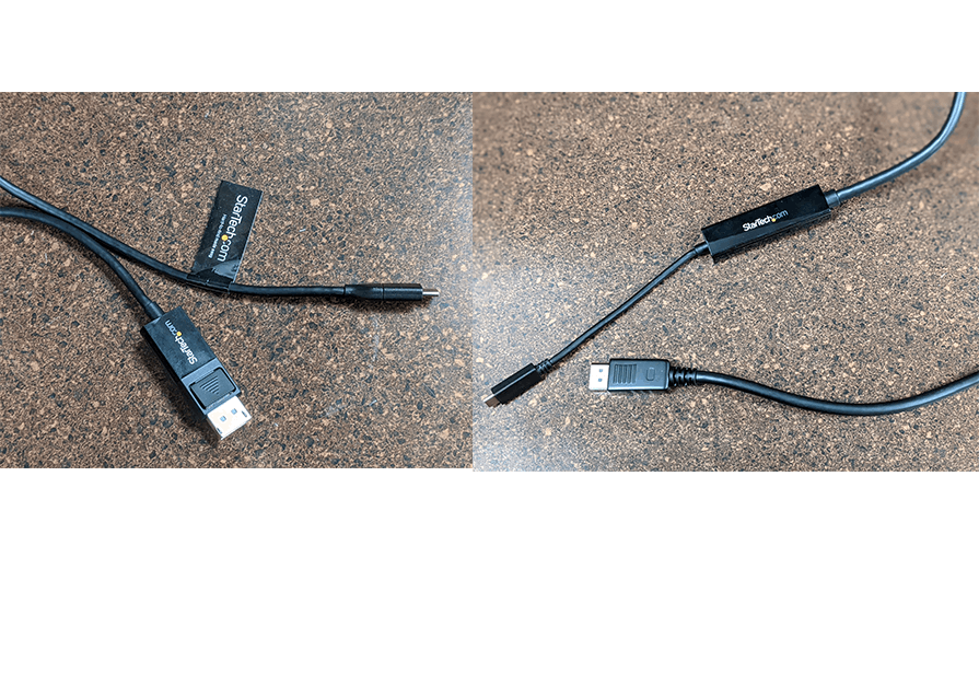

    Thank you and could you please send a link to the source where you bought these cables? There are a few from startech.comcom at Amazon but they seems to appear like the photo you posted. Thanks

    Hi Christy and MS community. Since my previous post on this issue I have found a solution and it definitely seems to in to what I thought the issue might be. So after trying 3 different types of USB - Display port cables some labeled as "Active" I finally found the ones that actually work with this poorly designed dock revision.
    I'm attaching pictures to this so you can see the difference between the two. The ones that work (right image) have components housed in line with the cable to help push the signal from the dock 2 and it is a much thicker cable as you can see. I'd recommend getting some of these and trying them out. All the previous usb c- display port cables we purchased as a company are all a waste now due to MS not using standards in their dock. Just my two cents on it but I do hope this helps you and anyone else that has this trouble.
