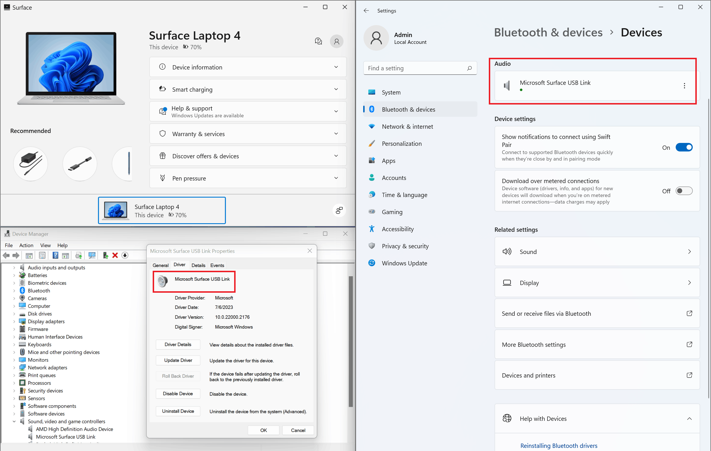

    2023-09-15T23:13:05+00:00
    I appreciate you for clarifying and providing us the photo, Roy_Cheng. We're sorry if none of the solution works. Let's continue working on this and isolate the issue.

    Hello, Lavenia
    First, thanks for your prompt reply. But I think you misunderstood my question and let me explain clearly.
    According to your troubleshooting steps and the problems is against Surface Headphones 2+ as you provided. But actually my question is against "Surface USB Link" Dongle can't recognize through Surface App.
    Because I lost my Surface Headphones 2+ Dongle(Surface USB Link), so I try to apply new one "Surface USB Link" Dongle from the website (Get a replacement for Microsoft Surface USB Link - Microsoft Support), after received the new one replacement "Surface USB Link" Dongle and connect the Dongle to my Surface Laptop, then launch Surface App found can't show Surface USB Link Dongle device in the interface, so I can't Pair my Surface Headphones 2+ with new Dongle.
    I also try to buy other new one "Surface USB Link" Dongle from Microsoft Store Website (Buy Microsoft Surface USB Link - Microsoft Store). Unfortunately, the new buy one is the same with previous replacement Dongle. (In Surface App still can't recognize)
    I also found some end user have the same situation and no solution to fix in Microsoft Community, could you please help highlight the problems to give us a reasonable explanation and solution? Thank you.
    Here're replacement Surface USB Link Dongle Pair step from Microsoft Website (Get a replacement for Microsoft Surface USB Link - Microsoft Support), but I can't find "Surface Headphones - Microsoft Surface USB Link" in Surface App after connected the Dongle.
    After you receive your replacement Surface USB Link, you’ll need to pair it with your Surface Headphones 2+ by using the Surface app.
    On your Windows 10/11 PC
    1. Plug the replacement Surface USB Link into the USB port on your Windows 10/11 PC.
    2. Select the Start button, then select Surfacein the app list.
    3. In the Surface app, select your Surface Headphones, then select Microsoft Surface USB Link > Pair.
    4. Follow the on-screen instructions to pair your Surface USB Link to your Surface Headphones.
    PS. I'm very make sure my Surface headphones 2+ is workable and functional via Bluetooth, but after lost my original "Surface USB Link" Dongle, it look like no any way to pair with new "Surface USB Link" Dongle through Surface App.
    Also attached the screenshot with the replacement and buy from website new Dongle, it can recognize in Windows OS "Settings - Bluetooth & other devices" page and "Device Manager", but not in Surface App.
    System Environment: Surface Laptop with Windows 11 OS and Surface App v61.23080.123.0
