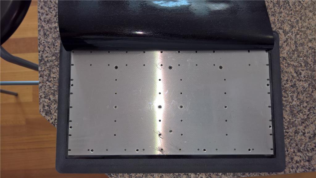

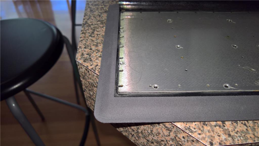

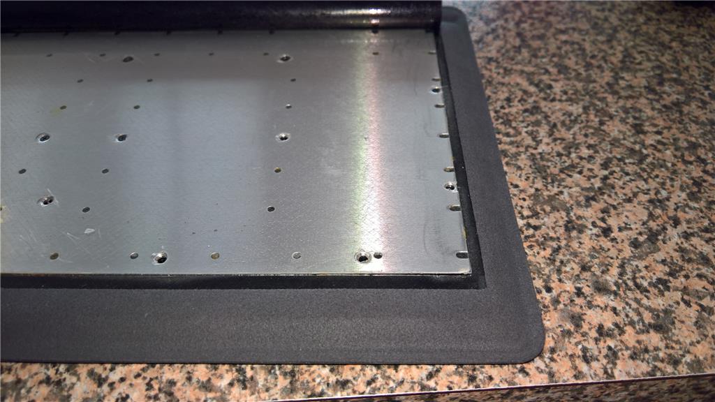

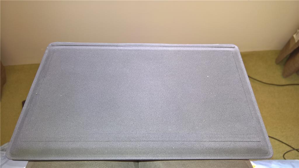

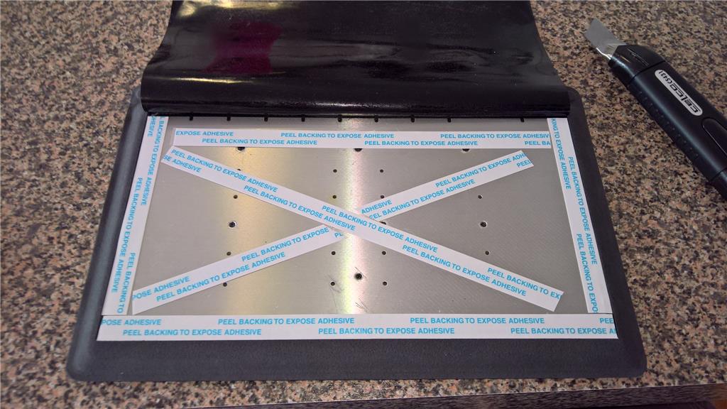

    If you're comfortable with batteries (li-ion can be volatile) and electronics you should have no issue.
    With regard to volt/current, I used a current limiting power supply set at 4v and 200mA with a volt meter monitoring it at all times. You will find that they will be in the region of 1.7v and as you apply the power they will fairly quickly ramp up to 3v at which point I stopped charging. I then checked the voltage again after a few minutes, and it was still around 3v, put it all back together, coupled it with my Surface and after 1 or 2 reconnections it started charging, not sure why this was required as but it immediately showed 100% !
