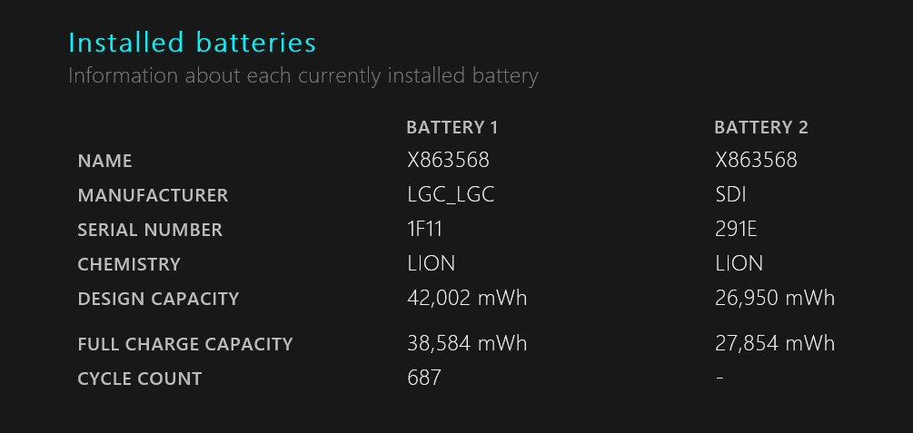

    2016-10-28T01:16:28+00:00
    It is working really well, I did a battery report after its first charge and it was showing higher capacity than what it was supposed to have :)
    No, unfortunately the battery will not eventually wake up as the voltage has dwelled bellow the BMS threshold voltage, as such the charging circuitry will not charge the batteries :(
    Bellow is an extract of the battery report that I did after the first charge, I haven't run one since as I have been playing with another keyboard, as such the report will be skewed.
