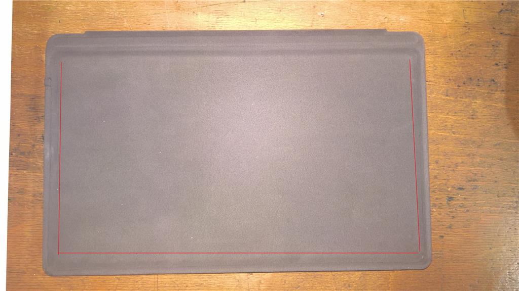

    Unfortunately no, the only way to gain access is to cut the fabric on the rear cover, under there is an aluminium plate covered in a thin plastic and held down with about 20 screws, once that is lifted there are 4 cells connected in series-parallel.
    Ill take some pics of the cover and mark where to cut if you are interested.

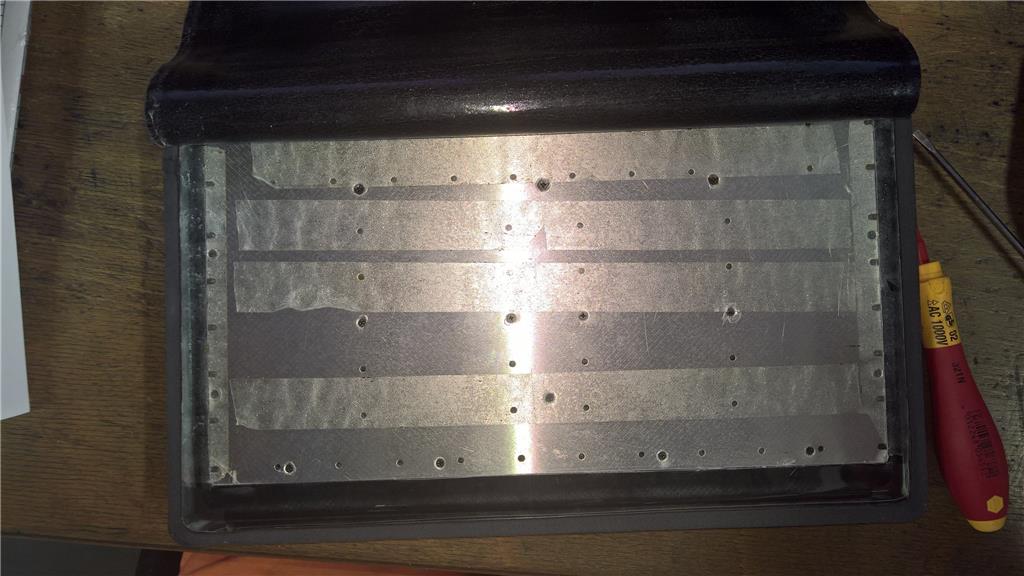

    Cut along the red line, see next pic to give you a better idea.
    Lift the flap up and you will see this (without the tape), cut out the plastic where the screws are and remove them, cut down the sides of the aluminium and along the bottom.

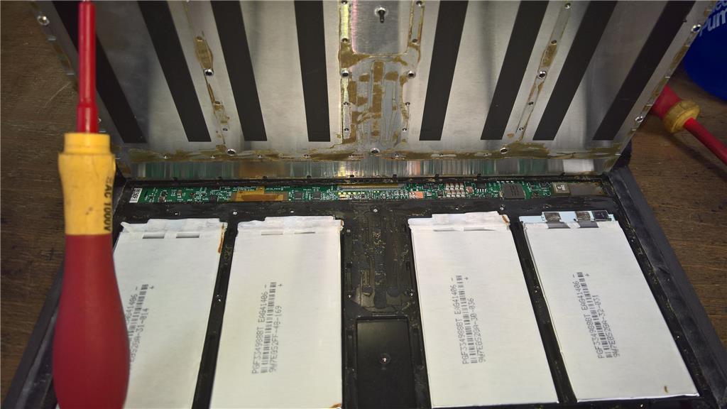

    Flip the aluminium up, and this will expose the 4 batteries, from my measurements the batteries are connected in series/parallel.
    DISCLAIMER: do this at your own risk, Li-Ion batteries can be volatile, just check out the pain Samsung are going through with the note 7 at the moment. Please read the link I posted above from battery university.
