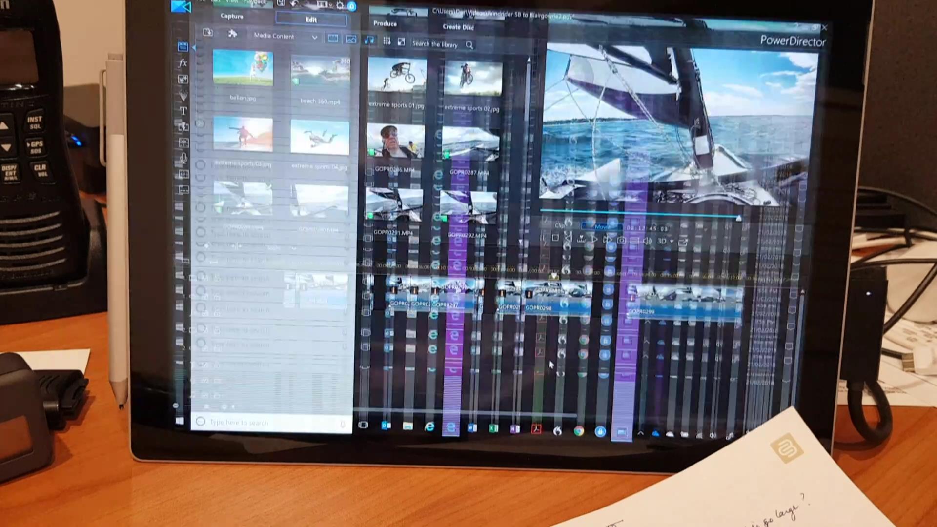

I purchased SP4 device a few months ago and it was working fine for a month. Then I noticed that when the CPU is at its max, the screen flickers a bit. Investigating further revealed that it flickers even if it is setting idle. It does not flicker if at least one of the following thing is done:
  1. A video being played in browser
  2. If I keep the touch screen busy by either taping it or keeping a finger on it
  3. If I use the touchpad
  4. If keyboard is used for typing
This resulted in making the device completely unusable while reading articles or ebooks. I am a developer, most of the time I have to read the code and to do that, I have to constantly keep a finger on the touch pad or the screen. I contacted surface support in October and November and was told that the developers are working on the patch. Looking at the updates the developers are pushing since then, I don't think anyone is even aware of the problem there.

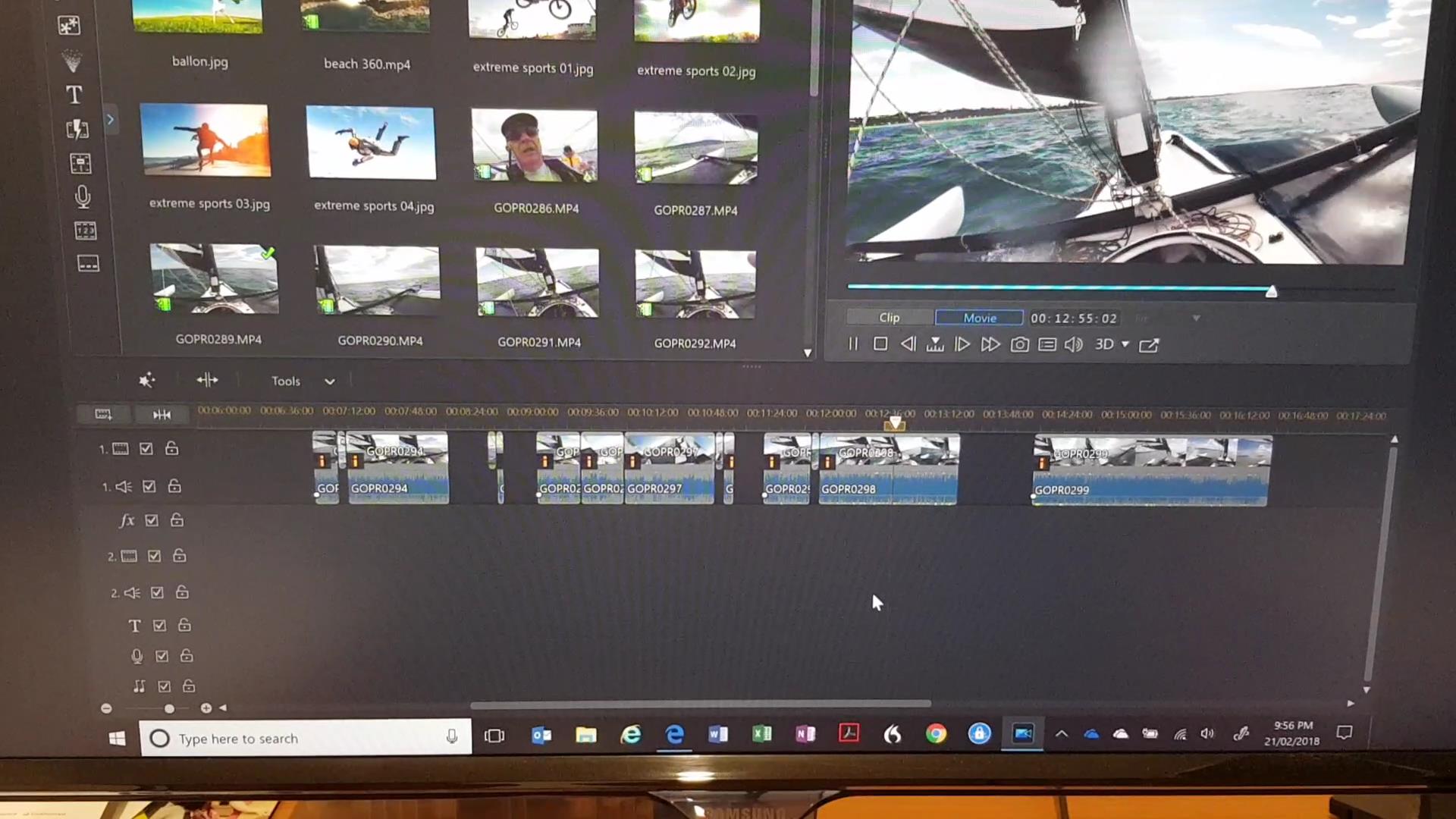

    My case was, totally out-of-warranty, told the support team that this is my only device for daily use, Surface Team offered me Advance Exchange Program, which they sent me a replacement unit, and I have to send back 1 unit to them within 2 weeks, if not, I will be charged for the price of whole new unit. After I received the replacement unit, I test and stress the replacement unit non-stop for 3 days, the machine was hot during the stress. And I saw no screen flickering issue, and decided to send back to them my problem unit after satisfied with this replacement unit in terms of cosmetic and software wise.
    I would not know the Advance Exchange Program is available in your region or not as I am in Malaysia and done the swap by above program, I have no screen issue so far and touch wood with this replacement unit, I am going to install heavy software and games maybe in near future as I said before in the thread and see how it goes.

    Microsoft pushed an update for the video driver a few hours ago. I installed and put my SP4 in a mode where the problem shows up - using a power point presentation on the screen where the clock and animated cursor are hidden. It usually displays the symptoms after a few minutes but it has been running now for 4 hours straight with no problem. For some reason the I had to force the update when it arrived - it failed to install on its own. Crossing fingers that this holds out.
