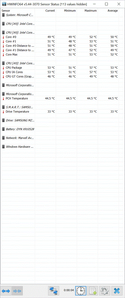

    Mine happens in UEFI so in my case it is either firmware related or hardware.
    The issue for me seems to be after some use, maybe an hour though I have run a few diagnostics that don't suggest it is a heat related issue.
    For example, here's a HWiNFO64 output of the temperature before the issue occurs

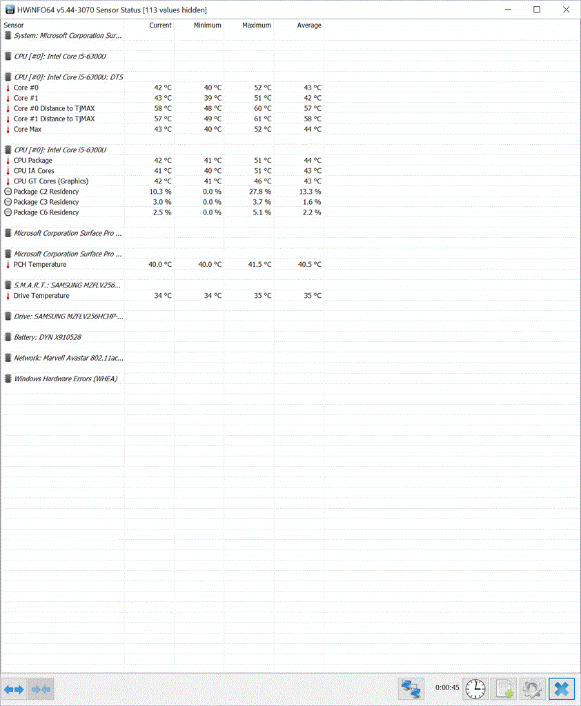

    Here is the temp after an hour when the shaking occurs when the screen is idle

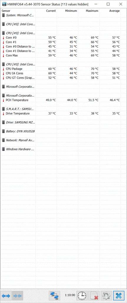

    I then tried reducing the load to minimal to cool down the machine as much as possible and the shaking still occured with the following temperatures
    Adding seconds to the taskbar clock seems to be a perfectly usable work around for me at the moment.  Ever since I did so I don't encounter the issue at all unless I specifically trigger it by hiding the taskbar and letting the screen idle.
