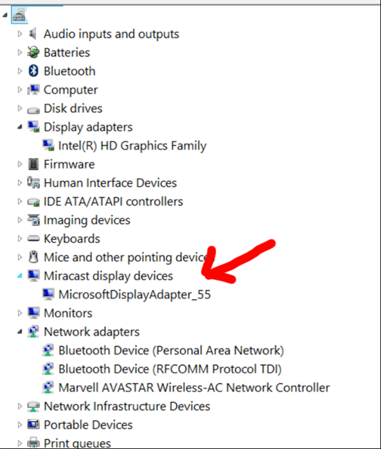

Here's how I fixed the problem without a system reset.
  1. Go into Device Manager and from View make sure show hidden devices s selected.
  2. There should now be an item that has an exclamation point. Remove it and all of the devices with the same name followed by #1 #2 etc if there are any.  I'm sorry that I didn't make a note of what it was and I can't remember. But if this is your problem, it will be there. Make sure to uninstall all of the same named devices.
  3. Restart. Do not rescan. I tried that and it didn't work. I had to restart to make it work.
  4. After a restart I slide in from the right side and selected Devices from Charms. I selected project and the Add a Wireless Display was back. I tapped it and it found the MS Wireless Display Adapter. I connected and it worked fine.

I'm sure this has been resolved already...however...I had the same issue with my Surface Pro 3 and would like to share what resolved the issue.  It seems this is an inherent Microsoft issue that haunts them since Windows 98.  I remember having graphic card issues back then and I quite simply deleted the graphics driver from the Device Manager.  That's right deleted - then reboot.
The MS Display Adapter works beautifully with my BlackBerry Z30...two clicks and I was connected.  Therefore, it's not the adapter.  The fix is the following with Surface Pro 3:
Search for Device Manager > Double click Display Adapters > Right click Intel HD Graphics Family > Click Unistall > Check "Delete driver software for this device" > Click Ok > Reboot > Once fully rebooted, follow instructions to install MS Display Adapter (open right charms > Devices > Project > MS Display Adapter...) then bingo! You are now connected.
