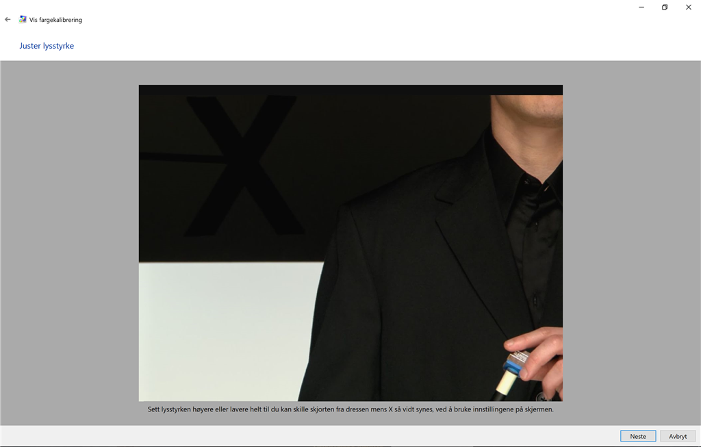

Going back to the steps given above, Have you already come upon on the gamma adjustment screen? In this screen, you can adjust the brightness of your monitor by moving the slider up or down.
Let us know if this works on your computer.
