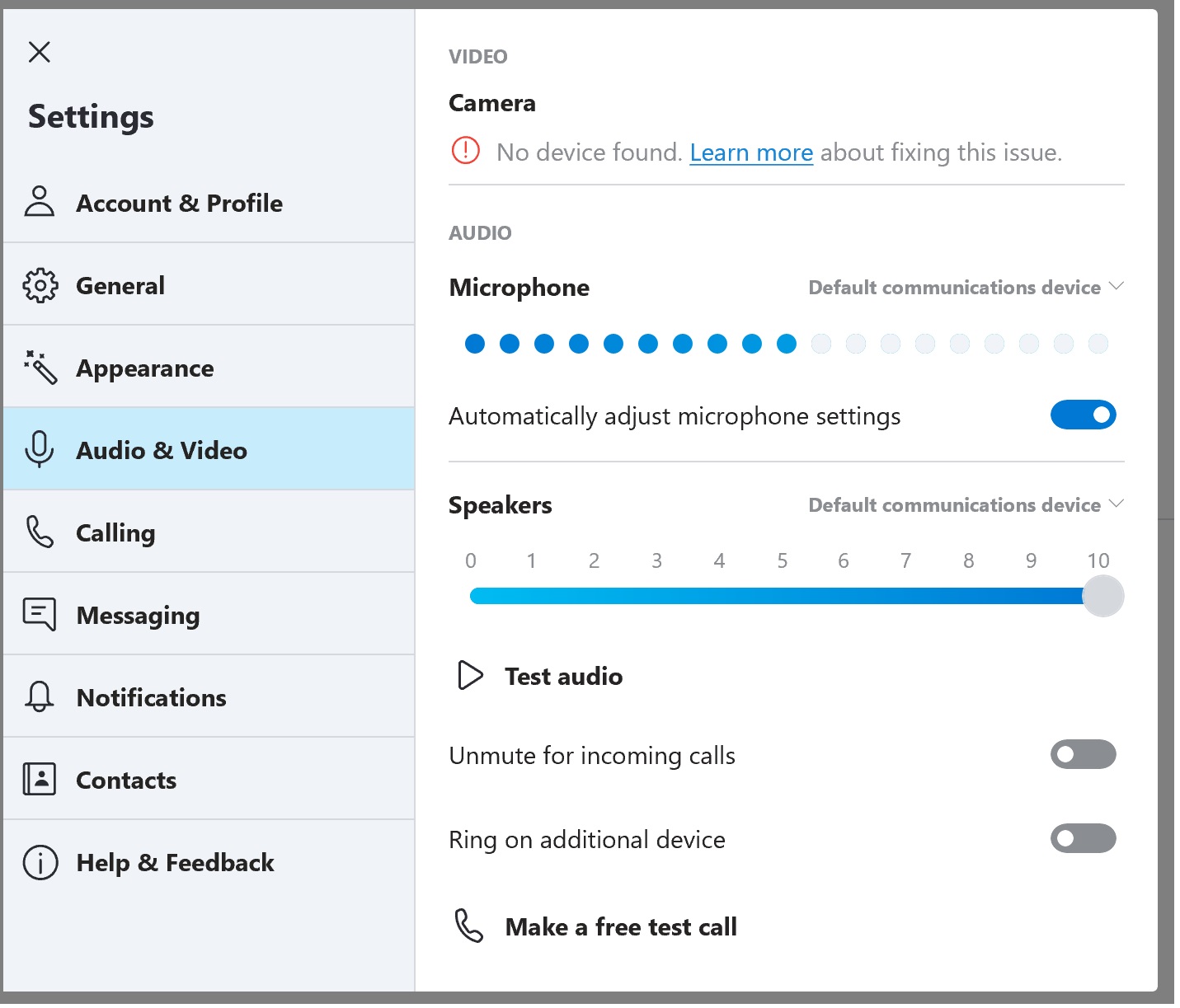

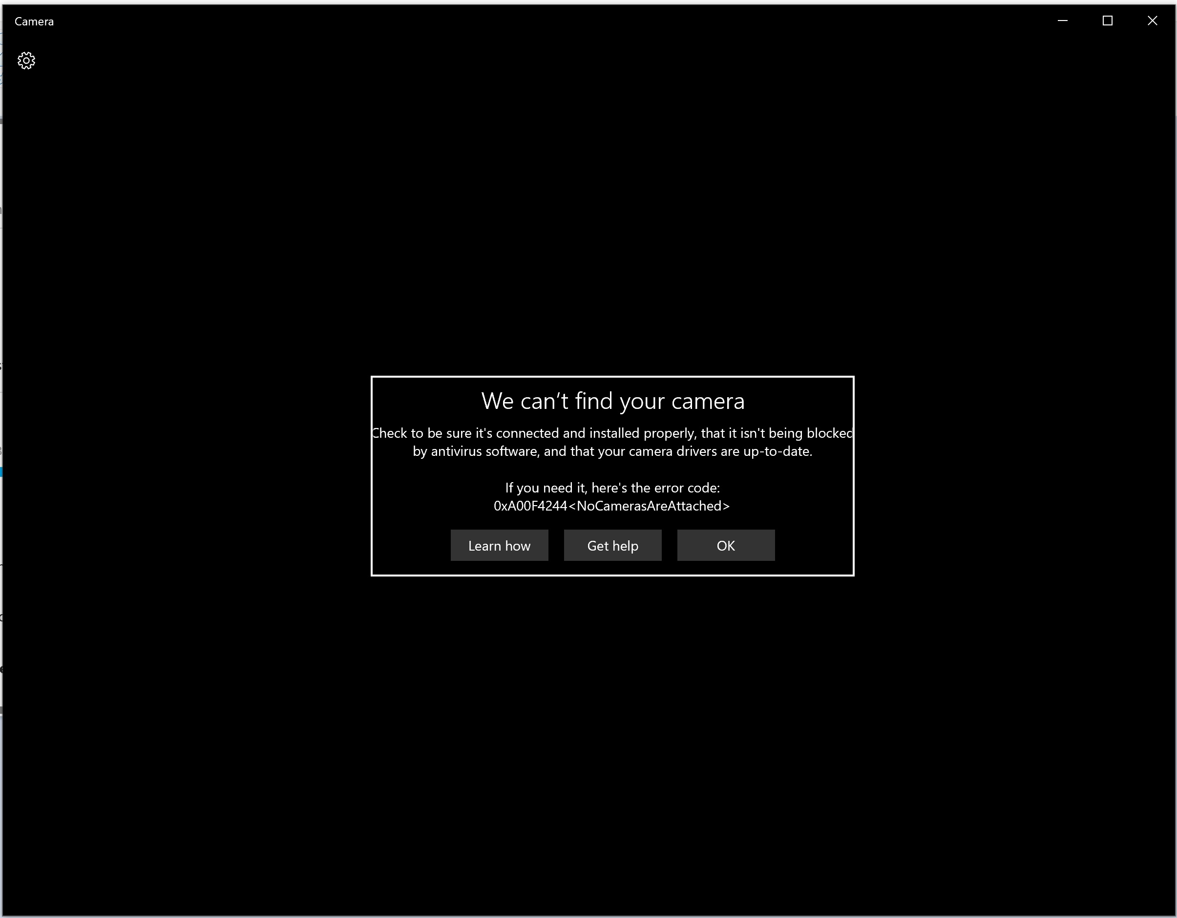

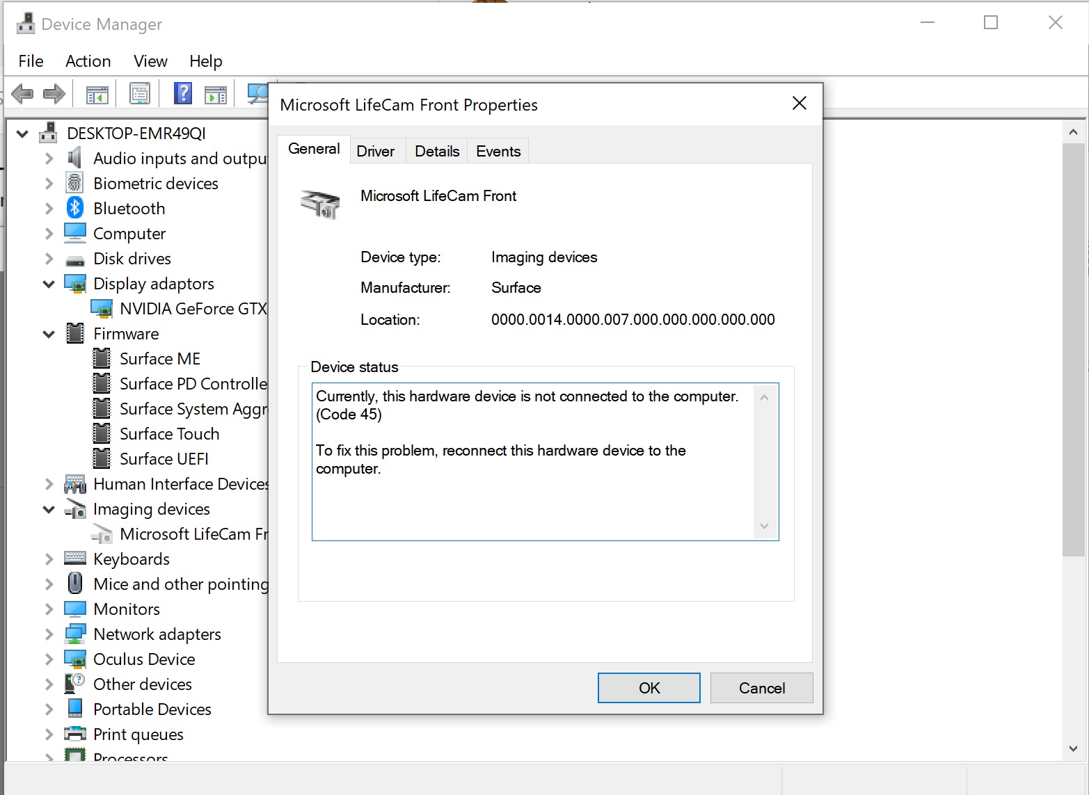

    Ok, I am back as my camera just disappeared again from the settings. Posting a couple of screenshots. One of Skype, one of Camera, one of the Device Manager.
    It will come back to life after doing the steps from my first post. Please advise what can I do about it as it's clearly not a mechanical issue.
