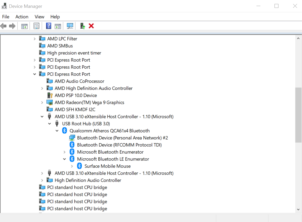

    I don't have a listing for Bluetooth Low Energy GATT compliant HID device on Device Manager under HID.
